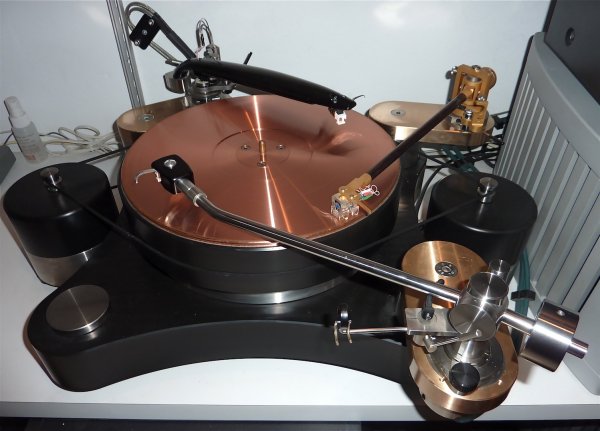

Very nice looking turntables. What type of technology uses the Raven AC2 motor/controller?
BTW, I think people appreciating the great japanese DD turntables will enjoy this site showing their internals and parts with great detail: http://www.amp8.com/amp-etc/record/record.htm
Doubt it , but only one arm these days. but the bass is different on each table for sure. You think your AC3 and DD bass delivery sounds the same?
The first step with the Raven is to obtain the most accurate and consistent speed possible.
Bass reproduction is the first casualty of poor speed control.
If your Raven's speed is optimised....it will produce a Frequency Chart with the Feikert Speed App more or less identical to the one I posted for my Raven.
If you upload your Chart here to demonstrate this, we can proceed to the next step:cool:
A tip: I found it impossible to obtain the correct stable speed with three motors....:eek:
Used to own a Raven AC3 . I don't think it's microprocessor controlled . Also it's speed drift. Tested it with Sutherland Timeline strobe . For the money it's a good TT
