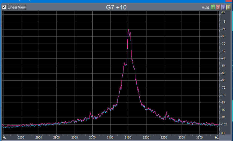

Balle Clorin Well-Known Member Apr 20, 2024 363 185 50 malta Jan 20, 2025 #81 @mtemur Using the V1 Analog magic test record it seem so be litte disturbance from belt now.. some old data on another test record, har to know if it is the record or TT that is the problem.
mtemur Well-Known Member Mar 26, 2019 2,640 2,778 420 50 Jan 20, 2025 #82 Balle Clorin said: @mtemur Using the V1 Analog magic test record it seem so be litte disturbance from belt now.. View attachment 144085 View attachment 144086 some old data on another test record, har to know if it is the record or TT that is the problem. View attachment 144087 Click to expand... I don't know how to evaluate those graphs. All I can say is narrow spike centered on 3150Hz without additional spikes on shoulders is better. I made assumptions watching the video of pulley, belt and platter you shared. From that I can evaluate but not from those graphs. Reactions: Balle Clorin
