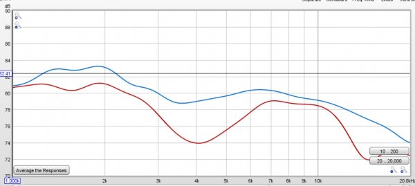

I am sure everyone knows this but for the sake of review. Harmonics are defined as multiples of the fundamental frequency being played. So these "peaks" in the frequency extend up from the note in a periodic manner. Each harmonic is successively softer than the previous one. (I pasted a picture of a trumpet note being recorded to illustrate. Ignore below 100Hz) Every instrument and every human voice has a different harmonic structure. This harmonic structure is what we call timbre. It is how we can recognize Bob's voice compared to Suzie's voice. Or how we know it is a trumpet or a clarinet. Or even how a trained ear can hear the difference between a Buffet clarinet and a Yamaha. If part of the harmonic structure is distorted or missing then the trumpet or piano or whatever will sound "not quite right" to you. To illustrate the magnitude of this there was an interesting experiment done. A note was played and recorded. In one copy all of the content above 20 kHz was deleted. Then people listened to the two versions. Even though it is accepted knowledge that human hearing does not extend above 20 kHz everyone could distinguish between the two recordings.
In reproducing music every component adds some distortion. There are different types of distortion but one type is harmonic distortion. Sometimes this can be a pleasing effect. We listen to music to enjoy it. So even though this distortion is changing the original signal if you like it then go for it.
The OP asked about missing harmonics. To me the number one place to look if you are missing harmonics is the frequency response of your system. If there is a big dip in the 5kHz to 10kHz range (as many systems do) then you will be "missing" the harmonics that are recorded. Most of this is related to speaker position and room acoustics. If the speakers have a bad off axis response and you have not treated the point of first reflection then you will get a timbre shift. If the speakers are not positioned accurately then dips will occur in the frequency response due to the acoustic interference of the two speakers. These things are relatively easy to fix and directly influence the harmonic structure that you hear. Things like footers and other tweaks do influence the sound but compared to things like listening position, speaker positioning, toe-in, rake etc they are second or third order effects.
I pasted a pic of a system I measured. This is smoothed to 1/3 octave. Notice the big dip between 5-10kHz and the drop off above 10kHz. After a slight adjustment to position and toe-in you can see the dramatic effect to the frequency response.
