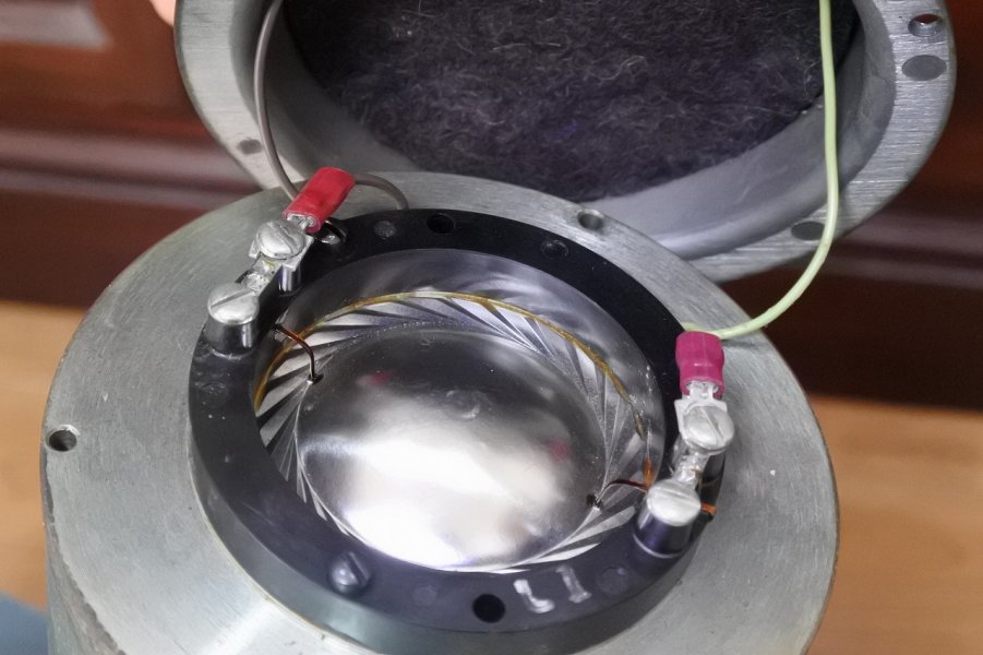

VC's should never flex. The leads to them are not the same material.
I thought some of the older compression drivers routed the VC wire through the tangential surrounds and it was a common failure point? Maybe not?
So what's your objection to aluminum?

Sure but again the leads are not the same as the VC. That is why on cones of lots of drivers you see the two dimples, it is where the leads are soldered to the VC.
VCs are not braided, they're just a solid core. That is one easy way to tell looking behind a driver.

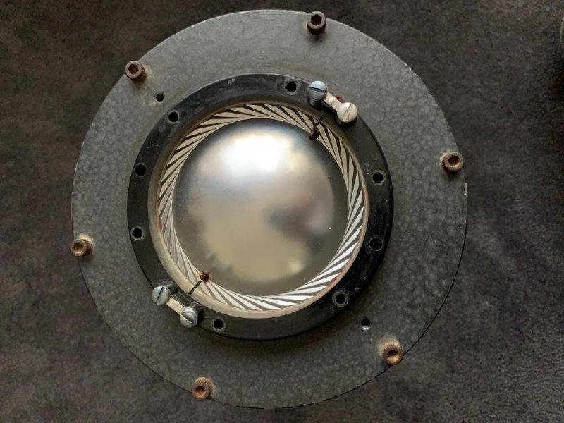

I understand that typically there are multistrand tinsel leads soldered into eyelets. Compression drivers usually use aluminum VC wire/ribbon. In the photo's I posted it's not tinsel lead but ribbon like the coil. And there were failures using a ribbon. Here is a better picture. Can't say for sure if it's VC ribbon or a copper ribbon bonded to the VC at the form.
That's why I brought up fatigue. The early Aluminum diaphragm's were life limited depending on use because of embrittlement from repeated flexing. The surrounds would literally shatter.

Ya, sure, there are lots of combos. I was primarily refering to any kind of a woofer like found in Klangs, Diatones, Tannoys, Electro-voice, etc. Compression drivers are another bag of worms. The focus on old vs new tends to not be on the compression drivers.

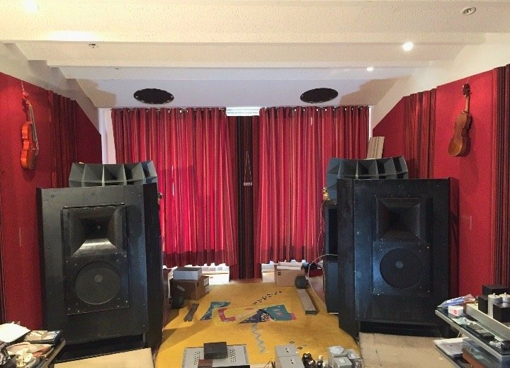

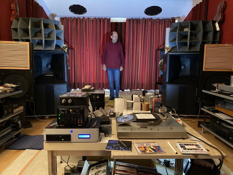

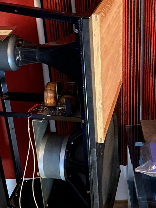

Heard these Eurodyn which were without the baffle. the baffle is kept at the side as it does not fit this room.

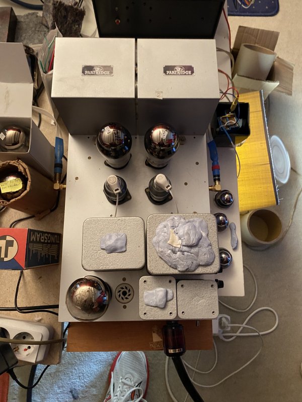

they were being driven Great by these partridge transformers AD1 amp with all Telefunken originals for output drivers and rectifier.
it is kept up on a stool in front of the “Altec”
this guy sold off 4 pairs of the Eurodyn, this Ian last. The tonality is very similar to the bionor and Euronor even without the Kondo. Only digital set up unfortunately.
the metal horn is replaced by a wooden one

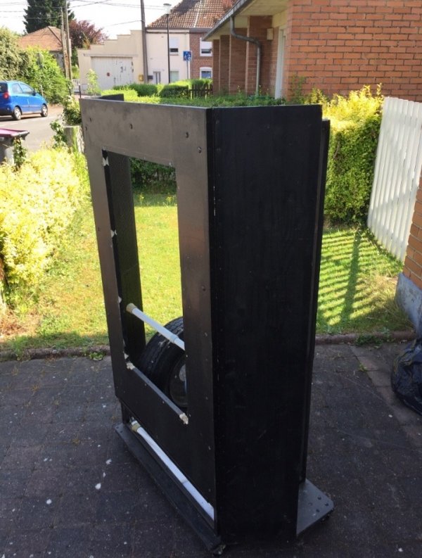

If he had out the baffle this is what it would look like

Eurodyn baffles have many shapes
