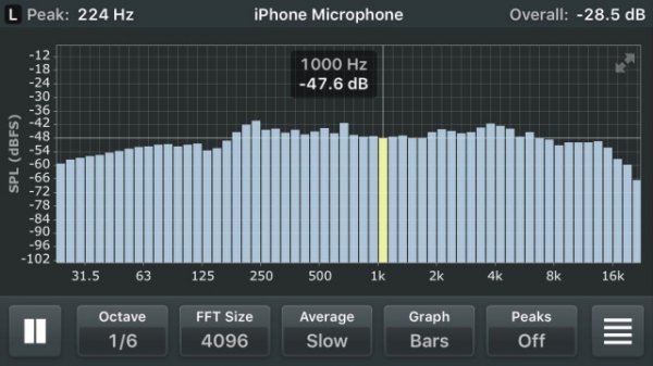

The most damning aspect of installing the JL CR-1 is that I no longer had the luxury of being able to precisely control the frequency response of the system. Despite every trick I knew, I was unfortunately at the mercy of the Pipedreams when it came to their frequency response in the midrange region. Despite some valiant efforts and try as I did, I simply could not contain a 5-7 dB peak in the region of 500K Hz that was due to a comb filter effect of the Pipedream midrange drivers. This imparted an upper midrange brightness that was unfortunately, just not sonically pleasing.
Fig 1. FR of Pipes/Gothams in my room
The TacT 2.2XP allowed me to flatten this anomaly almost perfectly, but now that I am TacT-less, and despite some efforts at acoustic damping of two select midrange drivers, plus adjusting toe-in, I just could not lick this nagging problem.

But where Henk was unable to show me a simple FR of his speaker system, Rich was very accommodating and did exactly as I requested by applying pink noise and taking a snap shot of the result on his iPhone using the Analyze program. Unfortunately the results were less than encouraging.
Fig 4. Rich Murry's Divas in his room
I want to be clear that I am in no way willing to base my judgment of any speaker system on any strict objective measurement. On the other hand, I am not dumb enough to believe that if the frequency response shows major deviations from what I consider reasonable, that I will somehow like the speaker in spite of its poor objective frequency response performance. After all these years, I cannot escape the mantra that it’s largely about frequency response. If the FR is simply bad, no other considerations will make up for deficiencies here. Frankly, there’s not a lot of guess work involved as to how something will sound when the frequency response contains obvious deviations from something that is considered reasonably well- accepted as good-sounding at the listening position such as the B&K curve or a reasonable facsimile. In the case or Rich’s Divas, it was just very apparent to me that they would have been bass shy and thus unsatisfactory. Yes, of course the FR could in part, be due to to room placement. Therefore I asked Rich if he could play with that a bit and repeat the measurement. And if that the FR could not be improved, could his filter network be modified to accommodate the request to improve the output of the bass panels? Reasonable questions, or so I thought. Unfortunately, at this point Rich dropped off the earth and ceased communication with me. To be honest I don’t blame him. He probably thought I was just too much work, and he was probably right. And thus my search for Apogee Divas came to a screeching halt. I was 0 for 2 and succeeded in driving two respected restorers to beyond the limits of their patience with me. Oh well, it was probably for the best, although it would have been nice as either pair of Divas would have been able to be purchased at about half my budget. But alas, it was not to be.
