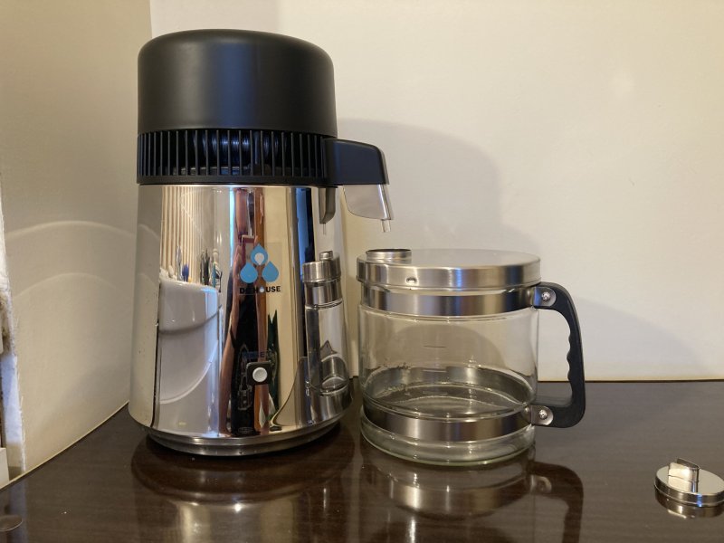

This has supplied my distilled water these last 4 + years. They’re on Amazon but made in China and not all are CE marked, the first one I ordered didn’t get past the EU border but the second one has the magic mark on it, though whether it actually qualifies I haven’t dug too deeply into, just checks with a meter. I run it outside in case of trouble as there’s an outside socket.
