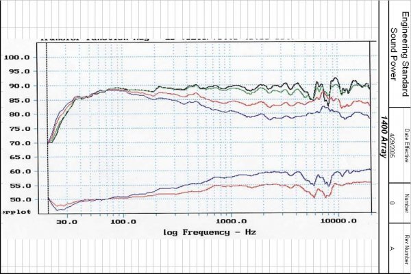

You should make clear if you are a anechoic or a inroom averaged "flat lander" . Otherwise we are comparing apples with oranges. FIY I am posting the anechoic on axis response of the JBL 1400 arrays.

The measurement you posted is not a true anechoic measurement it is a gated spliced measurement that suffers from artifacts. Fortunately JBL has an anechoic chamber so I know what the system actually measures like under those conditions.
I am an in room and anechoic flatlander.
Aside from?? Well designs are about compromise so either they have a rise on axis so it's flat averaged or they keep it flat and have a dip in thr averaged room response.
Attached are JBL's anechoic measurements.
5db and 7db dips in the tweeter? It must be reflective issues caused by the Horn section/baffle or something?
(microphone anomaly..)
See, even the JBL when measured does not show what you will actually hear when seated in the listening position!
I've heard a JBL 1400 driver by Arc gear and it is as neutral as a pool of clear water! No dips!

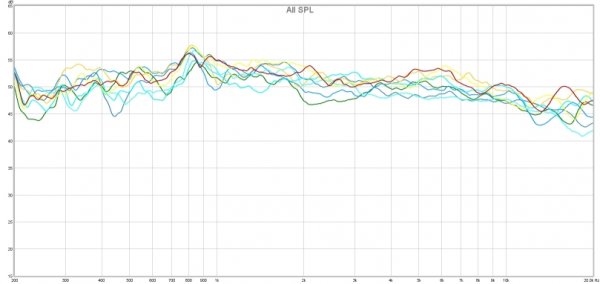

But now some serious :) stuff: my own measurements of the response in room of the X2 using REW and an ECM8000. They should be considered as raw data, with severe limitations and are in no way representative of X2 performance or specifications. But I hope those with good will see my point.
These responses were all taken with the microphone at the central position 11 feet from the speakers and 36" height , but I was moving the speakers about one feet from the from the front wall between each data taking. Minimum distance was around 4 feet. I tried to reproduce the vertical scaling of the Stereophile measurements (5dB division, 50 dB range) and used 1/6 octave smoothing to allow an easy comparison. Enjoy!

Microstrip, that is just a flat out impressive curve!!! The dude that installed your set really got the tweeter resistor just bang on!
(or something.. )

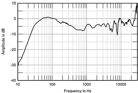

I would like to see a full curve before commenting, preliminary between this and the stereophile curves a picture emerges , hmm if it holds true obvious what Wilson is doing ..
Sly indeed .. :)
If true , he has sacrificed everything for summations at a fixed seated position ...:)
Measurements tells you everything , there's always a story ....!!!

But now some serious :) stuff: my own measurements of the response in room of the X2 using REW and an ECM8000. Enjoy!
Yes, I am now dealing with the 800-900 Hz zone now, I hope next run will look nicer.
Nice graph for such an early start in your setup! What does it look like below 200hz? Look forward to subsequent graphs...hard work!
Actually JA answers this whole topic discussion himself as i read the measurements more carefully , its all about distance,....i reckon
Above 250Hz, the XLFs' response in the Innovative listening room meets very tight limits: ±1.5dB. Again, small response peaks are balanced by small dips, but the response trend between 250Hz and 6kHz is a little flatter than in Michael's room. This may well be due to the greater distance to the listening position at Innovative: 128" vs 94".
As Amir would wisely say, the frequency response bellow the transition zone (around 150-200 Hz in my room) using such large speakers is mainly due to room dimensions and speaker placement. Interestingly, the results I got with the X2 are within a couple of dB what I got with the Aida or the Martin Logan Descent in similar positions. Because the room is very long I get significant response down to 15 Hz, but depending on placement a few deeps due to room cancellation modes show in the graphs. I have decided not shown it in this thread, as it is mostly a characteristic of the room, and in a thread with this tittle it will most probably be misunderstood by most readers. My apologies for those asking to see these graphs. :eek:
