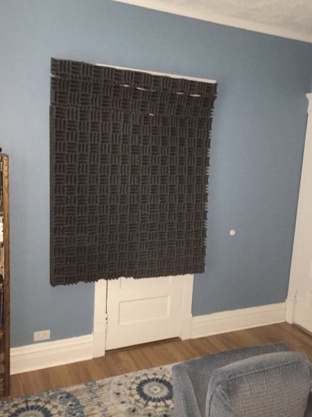

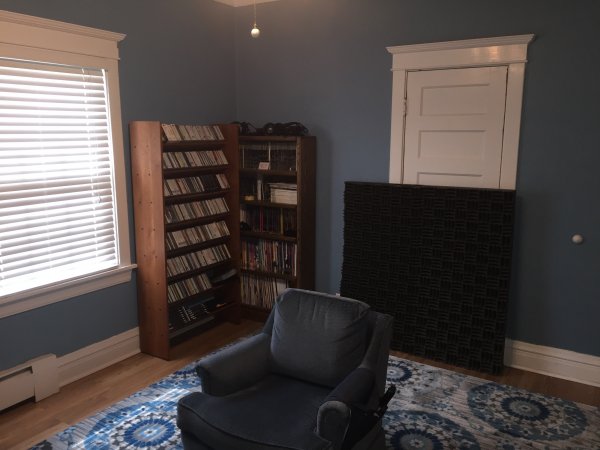

David Janszen suggested that I move the Sonex pads behind the listening seat upward to intercept the sound closer to where the treble is loudest when it hits that wall. I have tried this and it is an excellent suggestion! This makes a further, instantly audible improvement in three-dimensionality of the imaging and staging, as well a warming up the perceived tonal balance a bit. I aimed my Leica Disto laser measuring device at that wall with the rear side of the device flat against the thin edge of the baffle surrounding the electrostatic panel cut out to make sure I knew how high to put the Sonex panels. The Sonex panels now cover the portion of the wall where the beam hits vertically, as well as somewhat above and below that area to account for the three-degree up and down angling of the two electrostatic panels.
I have found that adding too much Sonex up too high on that wall deadens the sound too much and also causes the perceived position of the stage to go lower, down below the top of the speakers. I am experimenting with two additional narrow bands of Sonex placed above what is shown in the picture below. These would take the Sonex up almost to the top of the door frame, about another foot. Certainly applying Sonex any higher than the top of the door frame deadens the sound too much. The amount and placement of the Sonex in the picture does not deaden the sound too much or move the perceived stage position down at all. And, yes, I can still open the closet door covered by the Sonex because of the way I attached the Sonex to the door.
David has also suggested placing diffusors on the side walls by the speakers in place of the Sonex I now have there, and then turning up the Air Layer tweeters. I have ordered the AQD diffusors from PI Audio recommended by David, painted to match my Sonex. I'll try that suggested set up tweak next.
Upon further listening, I've determined that the sweet spot for the amount of 4-inch-thick Sonex used to treat the wall behind the listening seat involves adding another 11 inches of Sonex above what is shown in the previous post, so that the Sonex comes up to just below the top of the door frame. The block of Sonex then starts about 25 inches above the floor, is centered on the room width and thus directly behind the listening seat, is 4 feet wide and 4 feet 11 inches high.
This treatment seems to maximally enhance the width and depth of the stage as well as maximally stabilize and enhance the three dimensionality of the images on the stage. There is no decrease in the perceived height of the stage or images on the stage as long as the Sonex is not placed any higher.
This amount of Sonex behind the listening seat also adds a bit more warmth to the presentation, moving the presentation a bit closer in perceived balance to the lower frequency balance which was typical of the BBC-inspired Stirling LS3/6 in this room. I think the Janszen Valentina presentation is yet more neutral, but others might feel it still is a bit "cool" or "thin." For them, a remedy not involving electronic equalization would be to simply move the speakers a bit closer to the wall behind them. I have found the overall low frequency balance of these speakers, at least in this room, to be remarkably responsive to small movements toward and away from the wall behind the speakers in a very straightforward, predictable manner.

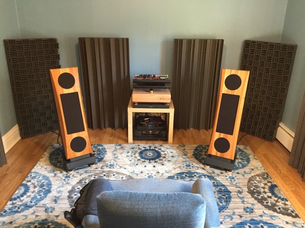

In a prior post in this thread I mentioned that, on the advice of David Janszen, I'd ordered the AQD Diffusors from PI Audio. I have now received and installed that set of four diffusors. PI Audio custom painted the diffusors for me in their paint booth to match the color of my Sonex panels. The Sonex is a charcoal gray color. The paint I chose from Home Depot is Behr Intellectual PU18-19. PI Audio picked up the chosen paint at their local Home Depot and painted them before shipping them to me. They are painted on all sides. The color match is excellent, even better to my eyes and those of my wife than it appears in the attached pictures. The total delivered cost for the custom painted set of four diffusors was under $300.
The diffusor panels each measure about 2 feet wide by four feet tall, which is about the same size as the Sonex batts I've been using. They also weigh about the same, maybe three or four pounds each. They seem to be made out of stiff, non-bendable polystyrene foam, similar to the "hard" padding material sometimes used to protect delicate items within an outer carton.
Again on advice from David Janszen, I'm experimenting with replacing not only the side wall Sonex panels with the diffusors, but also the Sonex panels on the wall behind and between the speakers. David also recommended that I position the Sonex panels I had behind and between the speakers toward the room corners for reverberation control. He further recommended that with these changes I should try turning up the loudness of the Air Layer side-firing tweeters to about the minus 3 dB level.
Both the Sonex pads and the new diffusors are placed against the walls at the first reflection points. That means that, using a small flat mirror taped to the walls, I center the width of the Sonex or diffusor panel on the point where I can see the reflection of the speaker centered in the mirror when sitting in the listening position. For the absorbing/diffusing panels on the side walls, I look for the reflection of the Air Layer tweeter and center the width of the panel on that reflection.
Before installation of the diffusors, I either ran the Valentinas with the Air Layer tweeters turned off or at midway between the minus 10 and minus 12 dB level. With my previous strictly Sonex wall treatment, raising the level of the Air Layer tweeters was either inaudible or just smeared the imaging a bit. Turning them off produced the sharpest imaging, apparently lowest distortion, and with only a small overall contraction of the width and height dimension of the stage, while seeming to enhance depth of field.
After a few hours of experimentation, I ended up with the pictured set up. The diffusors come in two male/female mated pairs. (The sex designation of the diffusors is somewhat arbitrary, but refers to the protrusion or recession near the center of the panel.) I used the two similarly shaped male diffusors on the side walls and the two female diffusors on the wall behind and between the speakers. I moved the Sonex panels which had been behind and between the speakers to cover the corner area behind the speakers, more or less spanning an equal length of wall area on the side walls and the wall behind the speakers. I have the Air Layer tweeters running at about minus 4 dB--the control is straight up and down and is between the marked -5 dB and -3dB positions.
What does this do? Well, for some reason the bass is further strengthened a bit as well as sounding yet smoother in response. Macro dynamics seem subjectively a bit greater. High frequency response is relatively unchanged. Apparent distortion seems to remain as low with the Air Layer tweeters on and turned up as with the Air Layer tweeters turned off.
The big change is in the apparent position, size, and openness of the presentation. The stage lifts a bit further up which is subjectively pleasing to me. The width and depth of the apparent stage are also increased, especially the width. This stage size enhancement comes without any blurring of apparent image positions. There is also an increased sense of wrap-around envelopment in the presentation. What was wonderful before is yet more wonderful now. This is a huge positive change for a relatively minor investment! The subjective increase in the apparent size of the presentation is not minor. It is an apparent significant and substantial expansion of the presentation, accompanied by a significant and substantial increased feeling of openness. The sense that the speakers have disappeared as the source of any sounds is further enhanced.
The level of the Air Layer tweeters is really a matter of personal preference. My goal was to expand the stage size without any other adverse effects. In my set up, turning the Air Layer tweeters up any higher than minus 4 dB begins to create a bit of a "hole in the middle" and "hot spots" on the extreme left and right of the stage, as well as blurring the imaging precision a bit. Yes, the stage further expands laterally with higher-yet levels, but the hole, hot spots, and slightly decreased imaging precision were distracting. The minus 4 dB level seems to me to be the sweet spot in my set up.
I don't know how translatable the positive changes I'm experiencing are to other speakers and rooms. In the past, I have strongly preferred absorption to diffusion in terms of acoustical room treatments. But the Janszens are quite directional in the higher frequencies and perhaps don't need absorption so much, at least for the room surface positions where I've deployed the diffusors. I strongly recommend than other Janszen owners try out these diffusors for themselves! There is much to gain and little to lose, given the size of your speaker investment.

[FONT=&quot]With more listening and experimenting, I have found that the Janszens sound very fine with the Air Layer tweeters turned off--at least as good as with them on--now that I have diffusers rather than absorbers at the reflection points on the side walls and behind the speakers. That's true even from outside the room. I still need the Sonex in the corners behind the speakers, on the ceiling and behind the listening seat, however.
Using the diffusers raises the stage height a bit even without the Air Layer tweeters turned on. Turning off the Air Layer tweeters increases focus a bit and changes the overall tonal balance slightly in favor of the lower frequencies. As I said before, however, at least in my set up, using the Air Layer tweeters and what level to set them at seems to me to be a matter of taste rather than a right/wrong or even great/a little less great decision.[/FONT]
I always enjoy reading your posts and have admired your approach for several years. As you (we) have learned, expensive does not always equal best and encourage you to continue to fight that battle against the machine!
With the PI Audio diffusers in place as shown above, I am now once again settled on having the AirLayer tweeters turned off. This makes the high end balance maximally natural, as in less bright and the imaging and staging seem most accurate this way, truly morphing from recording to recording. With decent recordings, I am continually astounded at how wonderful the spatial and tonal presentation can be.
One new discovery is that since the diffusers seemed to bring up the bass and warmth areas a bit, Preset 1 on the built-in amps of the Valentinas is now a real alternative for best balance with this system. In this set up, Preset 1 provides maximal bass extension and further smooths out the midbass response, allowing bass lines to be followed more easily while still providing nice weight and better punch. The bottom-octave foundation, while by no means absent with Preset 2, is with Preset 1 now yet more in evidence, providing truly astonishing low bass from such small speakers. Preset 1 also provides maximum clarity and lowest distortion at high SPLs on power music such as the larger Romantic period classical works and big band jazz.
