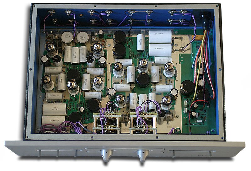

One of these was recently for sale for $4-5000. I considered making an offer but asked my dealer first for his opinion. He told me not to get it.

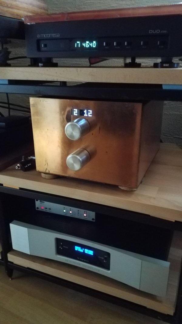

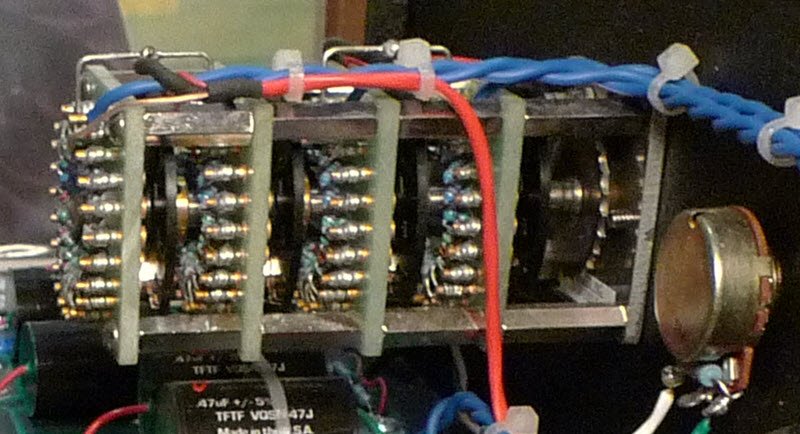

I use my diy tube preamp this autoformer volume controll with inputselector. Exsample picMakes me think of the hand built precision of the Atma-Sphere MP-1 volume control.

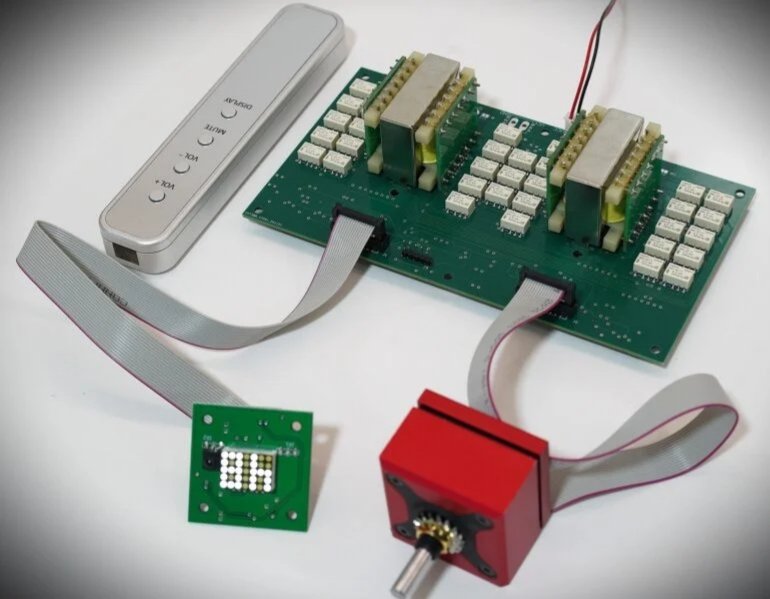

This khozmo stuff sounds really good, but expensive in pure silver 1.2kIf iRobot was a VC …![]()
Those are now so old that the filter capacitors in the power supplies should be replaced! Leaky filter caps can damage power transformers! That is something that would likely be very hard to find for something like this so its important to get this done if the unit is in daily service.

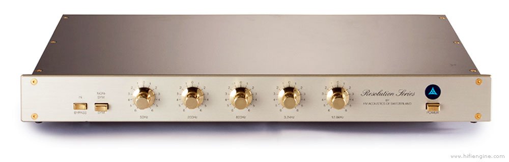

One of the very nice things about the Harmon Kardon Citation 1 preamp was its tone controls were built up on switches, so when set to flat they really were flat.Agreed. It's one of the silliest "high-end" inventions of the last few decades to declare that tone controls compromise the "purity" of the signal path. The Octave HP 700 preamp has an optional tone control which I did choose for my unit. Even though I rarely use it, it can come in extremely handy with some recordings to make them listenable (I sometimes use it on bass-shy rock recordings, life saver, really).
The tone control is very, very transparent, but when not using it, you simply bypass it entirely with a switch -- so there you have your "purity" of signal path after all. In other words, there is no rational reason to have no tone control at all in the high-end.
The issue with transformers used in a volume control application is the loading of the transformer. Since transformers transform impedance, the load at the output must vary with the change of taps. If not loaded correctly the transformer can 'ring' (distort; load impedance at the output is too high) or it can roll off (load impedance at the output is too low). IOW it must be critically damped for best response. Another reason for proper loading is if its not loaded (especially if the load impedance is too high) the inter-winding capacitance of the transformer will act like a capacitor bypassing the output, which will result in the output frequency response not being flat. To do all this correctly you have to have multiple switch contacts to provide the correct loading. The load of the input of the amplifier must not affect the results; this generally means the impedances used should be kept low.I use my diy tube preamp this autoformer volume controll with inputselector. Exsample pic

All the advantages and disadvantages are explained very well here.The issue with transformers used in a volume control application is the loading of the transformer. Since transformers transform impedance, the load at the output must vary with the change of taps. If not loaded correctly the transformer can 'ring' (distort; load impedance at the output is too high) or it can roll off (load impedance at the output is too low). IOW it must be critically damped for best response. Another reason for proper loading is if its not loaded (especially if the load impedance is too high) the inter-winding capacitance of the transformer will act like a capacitor bypassing the output, which will result in the output frequency response not being flat. To do all this correctly you have to have multiple switch contacts to provide the correct loading. The load of the input of the amplifier must not affect the results; this generally means the impedances used should be kept low.
