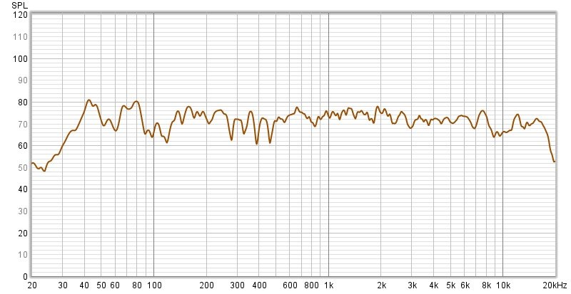

I took some measurements. Here is the SPL with 1/24 and psychoacoustic smoothing:
Obviously, there are some refelections and room modes causing a few dips here and there, but nothing serious. This is, after all, a living room, not a recording studio!
Bass extends down to 40hz, which is fine by me, and the response is pretty darn flat up to 20kHz. Above 10k, the response is highly dependent on the height and distance of the ears to the speakers, probably as a result of the line array topology.

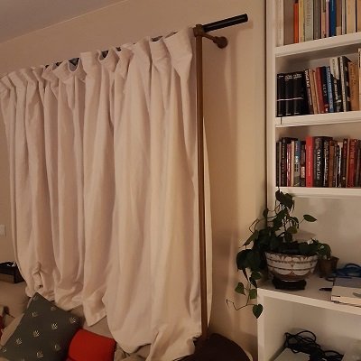

I installed Hofa acoustic curtains today - double layer, "studio" model. It covers a large window (220x220 cm - the curtain itself is twice as wide) behind my speakers, so facing my seating position.
Acoustic curtains are a really good solution, IMO, when panels are not an option. They obviously will not solve any bass issues.
I'll take measurements at some point, but it does seem to have a very positive effect, enhancing the sound quality of the system.

To further optimize sound quality - without permanently turning my living room into a man-cave (I do not have a dedicated listening space) - I devised a system to hang an acoustic curtain (3 layer Hofa studio model) behind my listening position, which can be installed and removed in less than a minute. When not in use, the vertical bars are stored under my couch, the horizontal bar folds in half and the curtains roll up around it so I can store them in a corner. The improvement in sound quality is quite noticeable, and I am happy with the results! :)
Reactions: Long Live Analog
