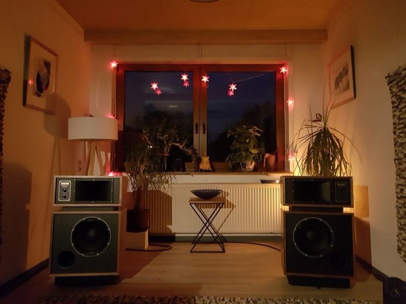

My next project start with 18"woofer too as ripole 8249455896_1_g.jpg 8249455896_0_g.jpg

re-labeled eighteen sound woofer (bastanis speaker mandala)not available today .when you build a ripole search for a woofer with fs ~ 35hz,qts around 0.4-0.6 and linear stroke of 6-8mm. Look beyma
Due to their smallness the chambers add a serious dynamic load to the drivers which leads to the lowering of Fs and raise of Qts.
The smallest chamber shows the greatest effect and depending on the driver parameters Fs may sink by up to 15Hz. You get around real -3db at 20hz.
