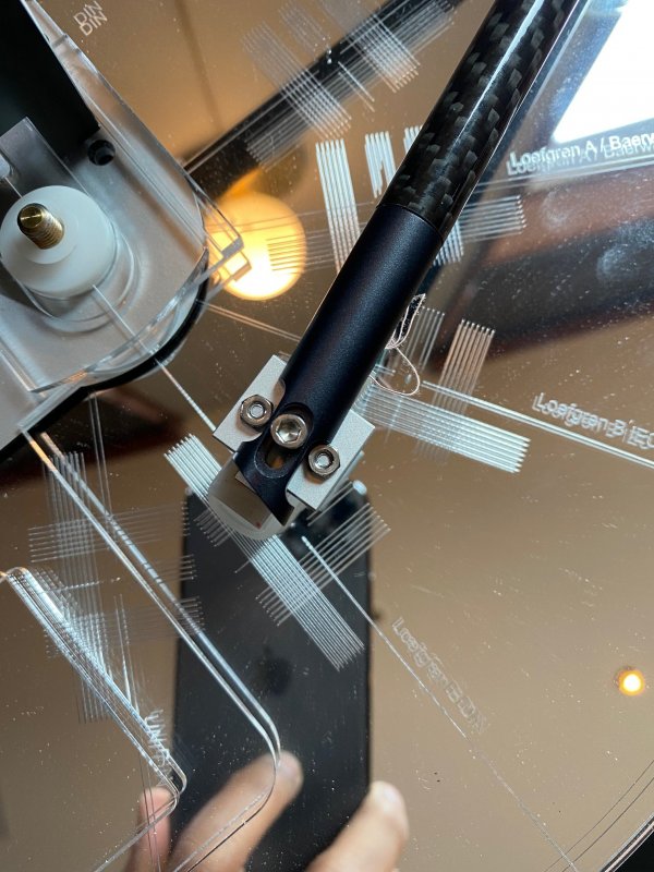

Hi Koetsu experts:
I recently got a retipped/rebuilt Onyx Platinum and am trying to mount on my Schroeder CB-9 tonearm with its standard headshell. This is the old style cartridge with unthreaded screw holes, which requires adding nuts to secure it. I'm running into an issue (probably newbie) where I don't have enough room to set up the cartridge so it's tangential at the null point (using a Smartractor). It's probably because the nuts and/or the screw heads are just a little too big to allow the full movement. I was curious if there are better ways to attach the cartridge - are there shallower profile screws/nuts that I can use? BTW, the screws are upside down since there's no room underneath for attaching nuts; I don't understand the design as you *have* to use nuts to secure it, but it does not have as much clearance for them. Not sure how these used to attached without the required clearance.
Thanks!

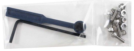

Hey Anil,
I have also run into this with the schröders. I can't tell what the head of the mounting screw looks like but if you invert them you may get a little more rotation. What you really need is mounting screws with a nut like the one pictured below. I have also had good luck using threaded inserts as nuts in this situation which can be quickly sourced via amazon. The 6mm long ones in the link may be long enough to allow you to remove the knurling on the bottom with a file and get the last little bit of rotation.
dave

Hey Anil,
dave
Great, thanks Dave! I will definitely check these out. Do you happen to remember what these are called, so can I search on Amazon? Now that you mentioned filing, it gives me an idea to see if I can knock off some corners of the nuts to give the cartridge mounting plate a little more room to swivel.

I would imagine that you should loosen the top bolt and move or adjust the offset.
Hi jadis: the issue is that even if loosen the top bolt (which I have done to move the plate) I don't have much room to "straighten out" the mounting plate so it's nicely parallel to the grid lines.

Can you reverse the bolt/nut to be bolt through top and nut on the bottom? My Koetsu mounting hardware is rounded. Both the bolt and nut. The nut has a cut for a flat screwdriver. Very slim.

I see. So it's about changing into a smaller nut as some have mentioned here, or put the nut the the bottom. Somehow I had managed to do that a few times with the Black and Rosewood which have no threads too. Good luck.

Anil,
They are simply called threaded inserts. The amazon link in my above post takes you to an assortment for $12. The forum software does not make the clickable link very obvious so it is included below.
Threaded Inserts
