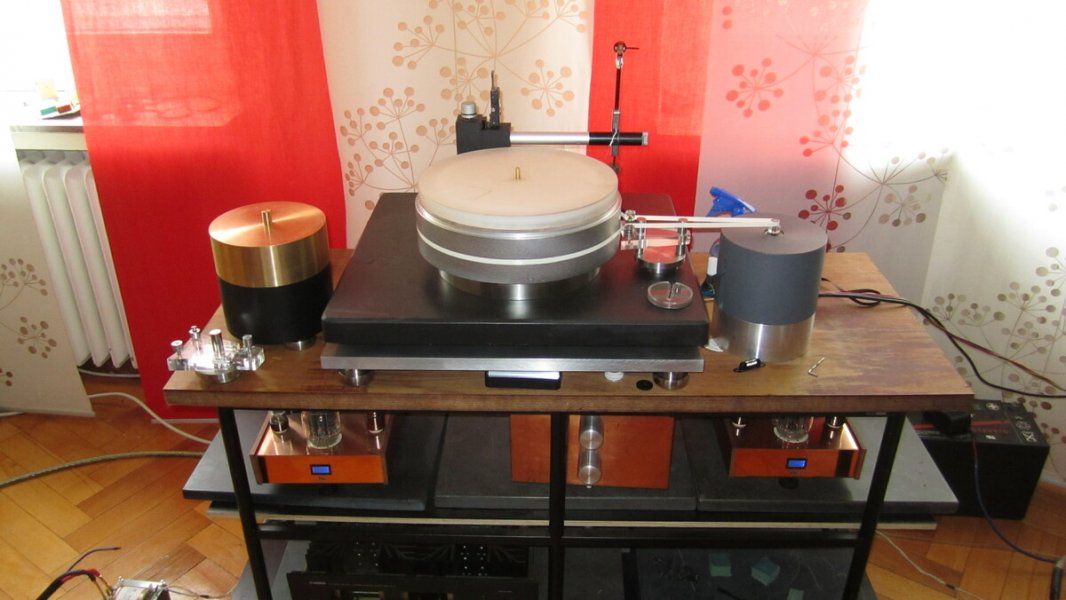

Every belt has a "stick and slip"effect thats physic,this becomes even worse if you reduce the wrap angle on the platter.
This extends the acceleration phase and also the braking phase of the engine.
modern fast control can compensate with a sensor on the platter or motor.
The better way is like this a great wrap angle on the platter, that elimate the stick and slip effect on a minimum. Otto Geraffel 052.JPG

If you by “stretch slip” or “stick slip” mean that the motor struggles to control the platter due to the elasticity of the belt — then i agree.
If it means that the belt is actually slipping on the platter then i disagree.
I cant see what good the construction in the picture will do — other than potentially tightening the belt and reducing its elasticity…
Again, why not completely eliminate the belt and put a wheel (idler) in between motor and platter ..?
