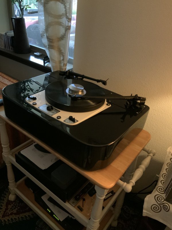

I am still suprised how these prejudices are stucked in peoples heads, idler always rumble. But for a long time in my life, i was thinking the same.
Luckily I went through plenty of comments at the Lenco Heaven forum so I could learn a bit before buying one.
I made a function test of my Lenco/PTP6 at the previous owners place and I was very surprised how soundless and quiet these idlers can run.
Directly after the Lenco was completd at my place, it started to rumble.
Reason: his stupid new owner forgot to loosen the motors transport screws before starting. :rolleyes:
Lesson learned!
Key issues for a silently running idler are imhO maintenace well done and a not too stupid owner. :p
