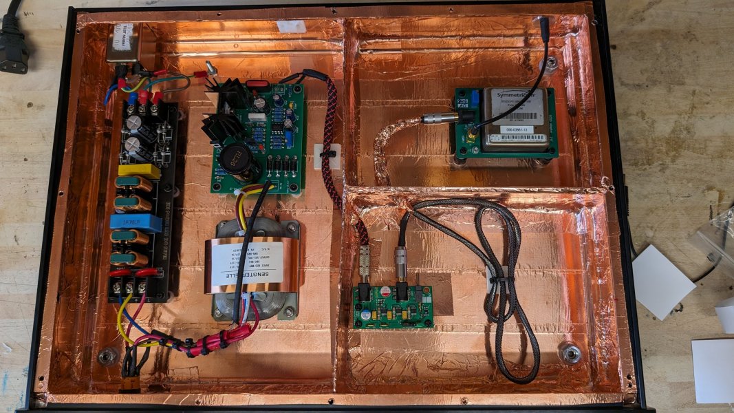

A high quality oxco does lift the sound for sure. My clock is self made using a -118dBc @ 1Hz unit.
Hi Nuforce, thanks! I also just ordered a rs130. Do you have a thread for the clock on diyaudio, or a component list or something, or is it made completely from scratch by you? I've been out of diy'ing for some time, would you think the Iancanada clock would be an upgrade to the internal one? Thanks for any hints

Unfortunately my thread was on a UK hifi forum that got closed down, but I'd be happy to list all the parts. The key is obviously the clock itself. I bought a hand tested unit like the below but from a different dealer.
The dealer I used sold me a -118dbc module but it wasn't cheap at $1000 USD but a bargain compared to a Mutek unit.1000006359.jpg

Thanks! I think I saw your photos on head-fi (?). I'm tempted by you guys getting great results with an external clock, and I might be able to manage such a project. Your noise seems wildly better than Iancanada's at 1Hz;

I've had great results with a r-core and ldovr lt3045 before, though I had even better results with a linear board from diyinhk. I'll have to investigate some more, might get back with more questions for you ;-) Thanks for now

Those figures are terrible! A LHY OC2 would be better than that. Honestly for the cost of the components I'm confident I've got something on par with a Mutec Ref120, or very very close.
Do they provide a report with measurements of the clock or is it just on faith that there is 116dB?

I advise placing LT3045 stabilizers as close as possible to the clock. they do not create RFI/EMI in any way, but you lose a lot on long wires and catch them out of the air.
Thanks
Yes, I got a dedicated report, showing -118 @ 1Hz.
I can easily shorten the cable, pls clarify what you mean by "lose a lot"?
The cable came that length and I was too lazy to shorten it, being completely honest!

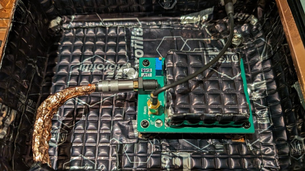

Since taking that photo I also lined the clock compartment with dynamat bitumen acoustic material.
The copper shield is connected to earth so acts as a faraday cage.
