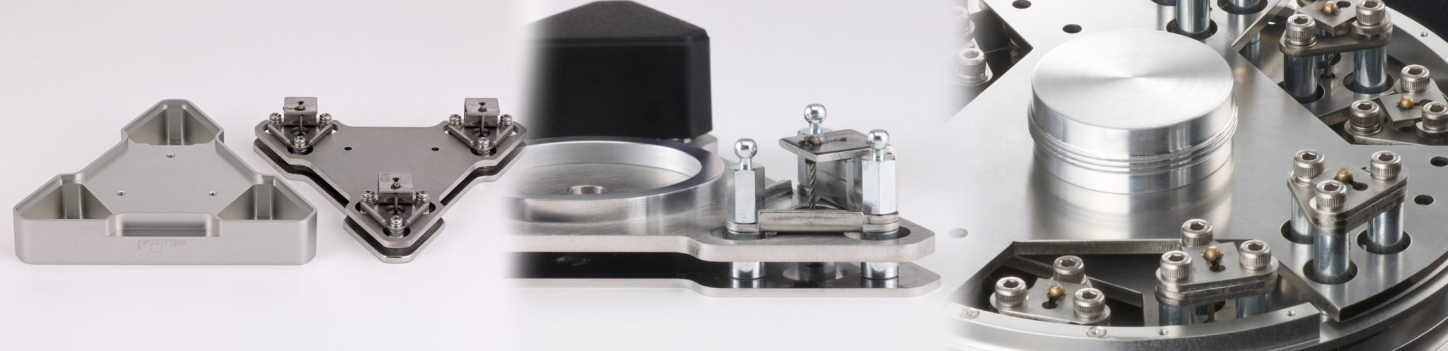

As is clear from the photo of the inner workings of the Wellfloat Delta footer (1st photo), each of the three rigid L-shaped cantilevers is effectively a small piece of "ceiling" from which the wire is suspended. With their top of the line product - The Babel (right side of 2nd photo) each little piece of "ceiling" has three supports (no longer a cantilever), and there are four layers of them. See any springs in these photos? The Wellfloat Babel by the way isolates down to the molecular level, something no spring based isolation system can approach.

A pendulum is not a spring. A pendulum provides periodic motion which is what we are trying to avoid by isolating our audio components. Mechanical vibration isolation is achieved with springs. Springs isolate, rubber dampens. Rubber can isolate at a specific, small range of frequencies based on material, shape and load. Spring/mass systems isolate from just beyond their resonance point to as high as you want to go. In audio, our goal is to design an isolation platform with as low a resonance point as possible. Dampers on the audio gear helps to absorb those airborne vibrations as well as any internally generated vibrations. A well designed audio component has dampers/footers tuned to its own internally generated vibrations.
The Wellfloat text tells you right in the first line that they developed a U shaped spring for their platform. They say it approximates hanging speakers from the ceiling.
Thanks for the isolation 101. Note that it is precisely the pendulum motion which is the basis for Wellfloat's (and SoundKaos', and Boenicke's) superior designs.
You have been reading and interpreting the Wellfloat website selectively. The U-shaped spring's function is described only under FAQ's in response to this question:

Nowhere in the three paragraph technical explanation (or in any review of Wellfloat devices) is it inferred that compression of the spring is the mechanism of isolation. Paragraph 3 in the technical explanation is entitled Fundamental Mechanisn 2 - Pendulum Movement and Distortion. The first line is the question: What is the reason why the pendulum movement can remove distortion?
In the Wellfloat platforms (cutaway side view attached) the cantilever/"spring" from which the wire is suspended holds the top board above/away from the base, and prevents pendulum movement until a component is placed on top. Once the weight of the component compresses the spring/cantilever (which can only compress/move in the vertical plane) it can no longer move, and effectively becomes a rigid cantilever as in the Wellfloat footers. All movement/isolation is then from the (horizontal) pendulum movement of the wire only. This is easy to appreciate by handling the device. When you take a Wellfoat board out of the box the top plate can be depressed a little and bounces back in the vertical plane. It also floats freely in the horizontal plane. Once it has the weight of a component on it no movement in the vertical plane is possible, and it takes effort to get it to move in the horizontal plane.
From the 6Moons.com review: "....Once weight mass loads the top board, the stainless steel anchor depresses to free the piano wire which can now move laterally like a pendulum".
Again, with the suspended pendulum design compression of a spring is not the mechanism of decoupling/isolation, horizontal pendulum movement from suspended wires is. Wellfloat's suspended wire design works completely differently from spring based devices (e.g., Townshend and DIY versions).
