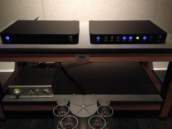

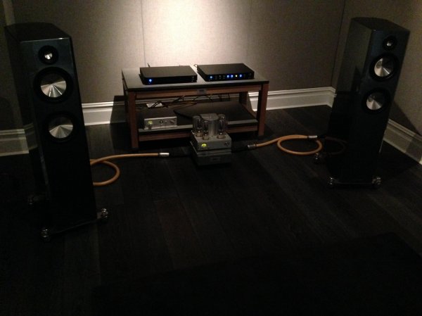

photo (1).jpgphoto (2).jpgphoto (3).jpgphoto.jpgFinally! Able to load pictures!
In any event, yes, I am buying the Trinity but also keeping the CH for another home. I can't get the Trinity sound out of my head. Never heard anything this solid sounding before, especially on 16/44. We listened to internet radio on it and it was startling. Seriously, we listened to an 80's new wave station and it was better than any hirez demo I've ever experienced. This is what sold me, not some BS audiophile recording that most dacs need to sound good! You were all right; the Trinity is spectacular...
