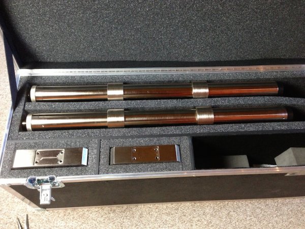

Opening the crates:

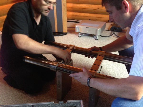

Assembling the legs:

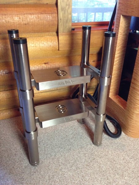

Stand is assembled:

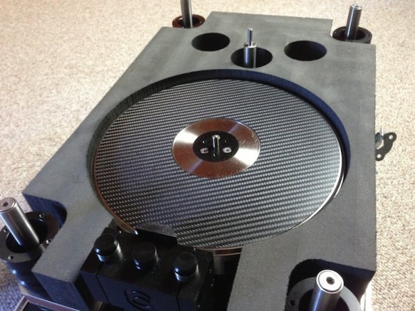

The carbon fibre platter:

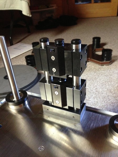

The motor assembly and sensors:

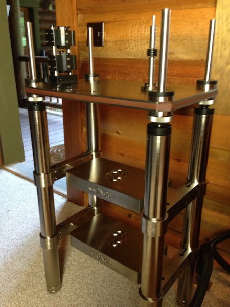

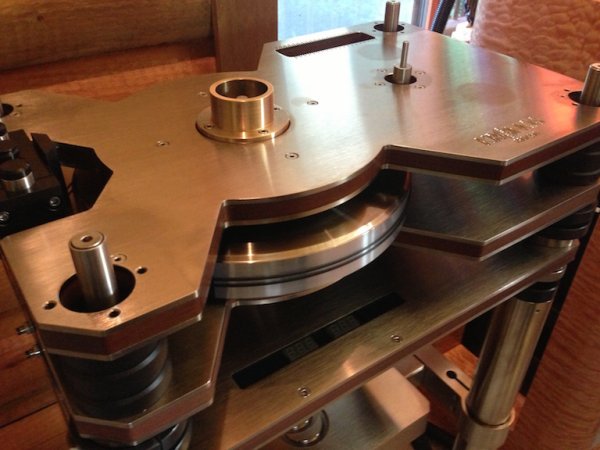

Table platform on its stand:

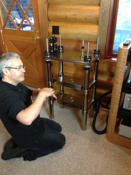

Louis describing the action of the platters:

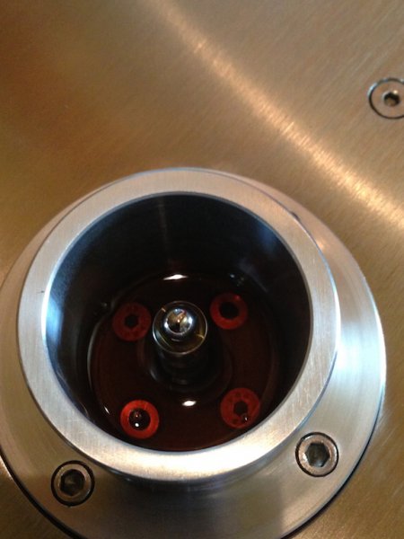

A shot of the bearing:

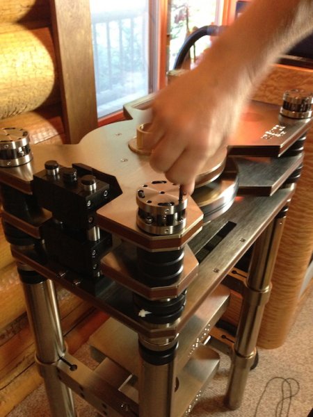

Installing and adjusting the suspension:
Adjusting the belts:

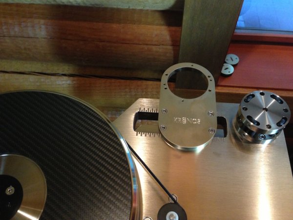

The arm mount:

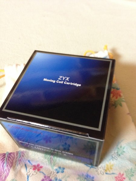

The incredible ZYX Universe cartridge:

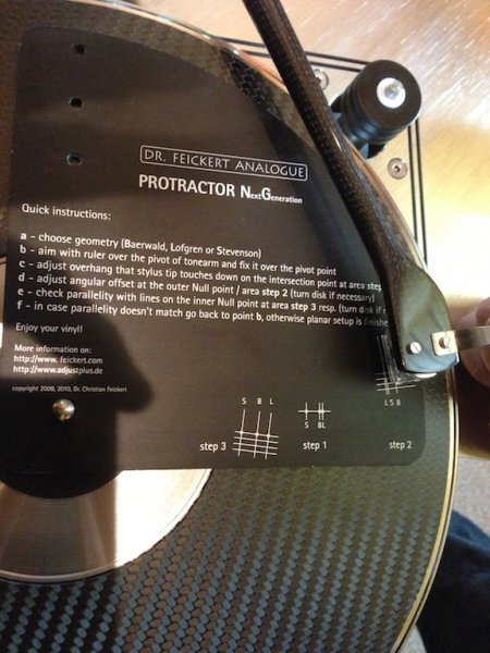

Aligning the cartridge

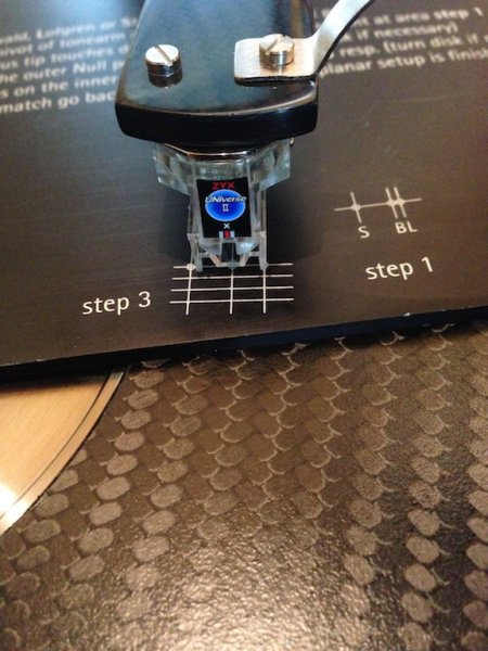

Setting the azimuth for the cartridge:

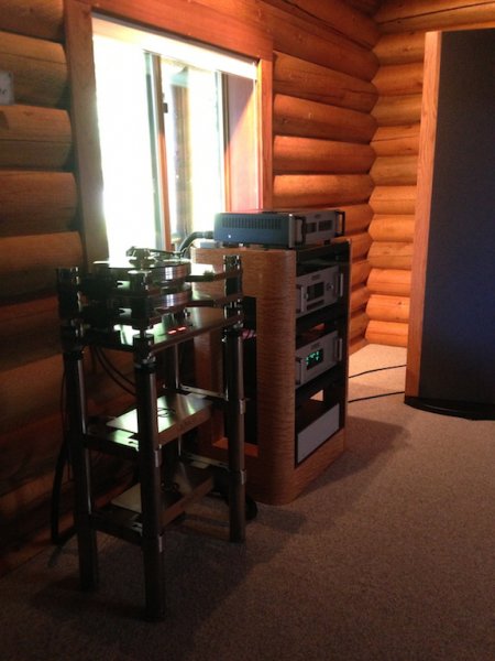

Finished install and ready to play:

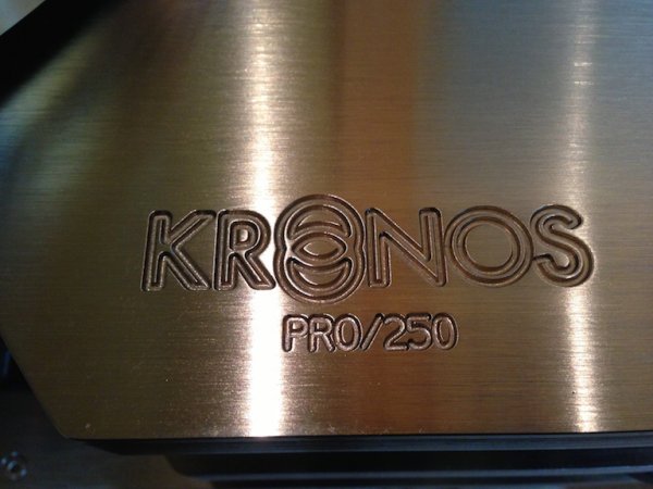

KRONOS PRO-250

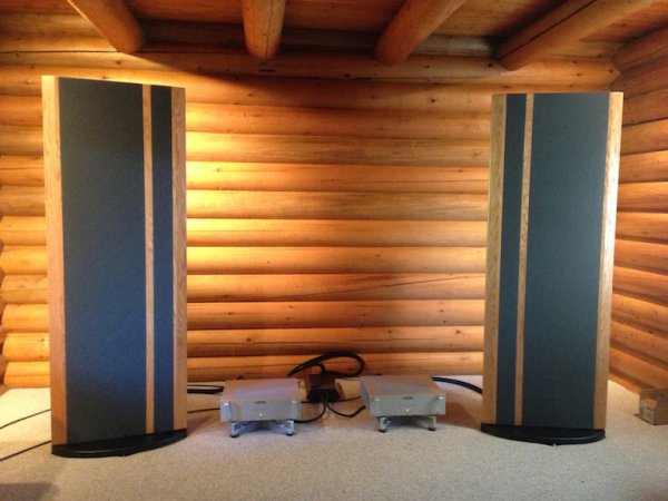

A shot of the Maggie 20.7's playing a 1950's Jim Reeves album:

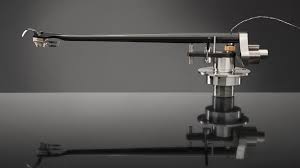

Oh, I can't forget to mention the Andre Theriault Black Beauty tonearm. Multiple layers of solid carbon fiber. Mounts on a single bearing. No strings, wires or other supports.

Is that stand included as part of the Pro/250 or is that an added option
I didn't realize that Louis had brought the stand to market

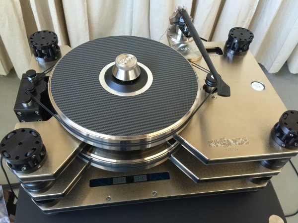

Cool! We got ours too, all set up, but still waiting for the cart, an Ortofon A95 that should be arriving soon!
Alexandre
why are the 4 corner posts on yours black plastic and the 4 on Caelin's are polished chrome
Plastic was indeed a poor choice of words . I like the look of the polished chrome on Caelin's unit better than the darker posts

Could you explain how this photo describes setting the azimuth? What is the process? To me it looks more like the lines are used to align the edges of the cartridge for proper Zenith setting. That is, making sure the cantilever matches the tangent line at the null point. A similar alignment guide is printed on the MINT protractor at the two null points, though there one actually aligns the cantilever itself at the null point rather than the edges of the cartridge.
The headshell has mounting holes rather than slots, so how it the overhang adjusted and is there enough play between the mounting screws and holes to rotate the cartridge slightly in the headshell for zenith adjustment?

The template shown was for lateral cartridge alignment but we were doing several adjustments at the same time. I am not an expert although I have had many turntables since the 1970's. Louis did all the setup and I just observed. Actually, the azimuth adjustment is unique since there are no wires and anything else attached to the arm. I should take a closeup photo so you can see how the arms is "mounted". It just has a ball attached to the bottom of the arm and that ball sits in a cup that has a lubricant in it. The counter balance weight can be rotated around the polar axis of the arm which causes the azimuth to change. But the arm just floats in the ball cup - no other attachments. I had a Well Tempered table and arm that was pretty elegant but this is even simpler.
The Kronos uses DC motors that are digitally controlled for speed. Each counter-rotating platter has an independent motor and is controlled independently.

Very cool and congratulations ! Curious how a log cabin room sounds? I suspect the walls really help with difraction
Maggie's are great speakers...hard to beat for the $$'s
