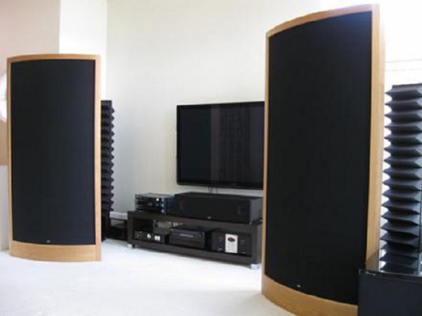

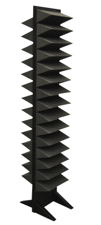

I think these Sound Lab - Sallies are interesting devices.
http://blueskiesaudio.com/ View attachment 62916 View attachment 62917
Has anyone experience with something similar?

I've never heard Sound Labs, I was just asking if ayone has heard the Sallies behind them, or DIY variation on another brand of panel speaker.
https://www.soundlab-speakers.com/accessory.html
SALLIE is an acronym that stands for "Sonic Attenuator for Lower Levels of Interference Effects". Dipole speakers, such as Sound Lab's full-range electrostatic speakers, radiate equal energy from the back side of the panel. If the listening room is over-reflective audible interference patterns can result, manifesting an undesirable condition referred to as the "comb-filtering" effect. SALLIE greatly reduces this effect and helps save on expensive acoustical room treatment. Furthermore, the effect of SALLIE is adjustable by simply altering the distance to the back of the speaker. SALLIE isn't visible since it is placed behind the speaker.
I bought a pair of Sallie's back when I had a home showroom with SoundLabs. I didn't "need" them but wanted first-hand experience so I could offer advice about when to use them and when not to.
The Sallies are an excellent solution if you have to place the SoundLabs fairly close to the wall behind them, say less than three feet. Ime when the backwave arrives too early, it tends to do more harm than good. On the other hand if you can place the SoundLabs further out from the wall, ideally five feet or more, the path-length-induced time delay on the backwave is sufficient, in which case imo the backwave is beneficial.
The curved geometry of the SoundLabs results in a "focal point" a couple feet or so behind the diaphram, and when the Sallie is placed at that focal point, it does its job (absorption) very well. I had plenty of room behind my SoundLabs so I sold the Sallies after I had become familiar with them.
