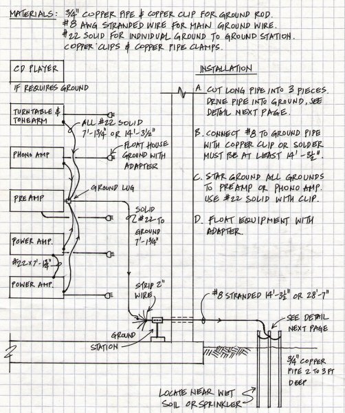

The grounding consultant visited the house yesterday and is putting together an estimate to use chemically-encased ground rods to lower the impedance to ground to 10 ohms or less.
Yoh Ron , Sounds like having "fun" creating the ultimate sound room --Kudos
re Mc Carts--You should add the Miyajama Madake to your list--it outperformed the Shindo SPU and Ortofon A90 for me
also the House/System Grounding-- have you considered this---
BruceD
Jan 24, 2015
16,221
13,684
2,665
Dear Bruce,
Thank you for posting the diagram! Except for floating the ground on the phono pre-amp I believe your suggestion is exactly what we will be doing -- star-grounding everything to a true earth ground.
Thank you for the cartridge suggestion. (More options?!?! : ) I believe Touraj of Vertere has the Miyajama Madake on his reference demo set-up.
However, because (i) I am no longer much of a DIYer, and (ii) the dry soil in Southern CA makes it difficult to get good conductivity, I have engaged Lyncole, a specialist grounding company, to prepare a bid to do the exterior earth ground part -- with multiple, chemically-encased ground rods to get the resistance to ground either below 10 ohms or, if I double the number if ground rods, to below 5 ohms.
If anyone has any view on whether a resistance to ground of 10 ohms or less is sufficient, or if a lower resistance of 5 ohms to ground makes a big difference, please let me know!
