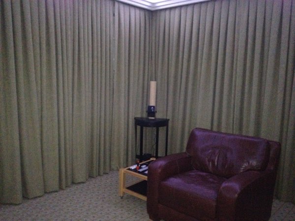

Hi Ron, since your room is indeed big enough to allow the appropriate positioning of the speakers away from the boundaries, the preference for reflection can yield a good soundstage as you've experienced.
The desire for symmetry on the walls flanking the speakers can be met by measuring the reflection path from the panel, to the front wall, the ricochet onto the lateral and the eventual bounce back towards the interior of the room. This is a function of the amount of toe-in you use, so factor that.
Ideally the lateral reflection point and a couple of feet beyond are perfectly symmetrical side-to-side. After that, openings, while having an impact, will be much less critical. But 3 or 4' of variance in the lateral reflection point will skew the soundstage as the reflections on the side with additional depth will have 3 or 4ms longer delay. If the additional delay also happens to align the inevitable dipole comb-filtering with some room mode, then you also get frequency disparities between sides.
Even if the acoustician places a drapery system across that opening, the delays will still be there at frequencies that can traverse the drapery (a function of how heavy the drapes are, but much of the HF will be cut), So I'd suggest some self-standing panels placed behind the drapes to achieve the symmetry at the lateral reflection point.
As you probably know from reading about my system, I'm very much in the absorb it all camp, but then my priority is high-performance multichannel which requires more emphasis on the direct sound. But I get why some prefer the 'dipole ambiance' effect. It's just that if going that way, I like to help people understand the importance of rear wave management in that context.
If Bonnie uses the same design principal as mine the drapes are not simply drapes but because of the large 2.5:1 horizontal pleating as well the drape being lined with her OEM Lumitex
http://www.soundsense.com/wp-content/uploads/2014/07/Lumitex™.pdf
which essentially turns the drapes into a large bass trap. She uses other materials in the floors (Noiseout) as well as front wall treatment with another OEM called Paradise Foam
IOW after her treatment there are no frequencies which can traverse the draperies. People always comment about how they anticipated the sound in my room would be dead because of the heavy treatments but after they hear it they always say that "she nailed it. People always warned me before I went down the road to build my room that the sheer weight and size of my speakers and their proximity to the front and side walls would blow the back end of the room off. Quite the contrary. The room measures quite flat across all frequency spectrums. I guess I got lucky BUT having said that she knows what she is doing. She has a combined pHD in acoustics, mathematics and electrical engineering which allowed her to write a program for mathematical room mapping. I've told this story before but initially where I placed my main equipment rack along the side wall later showed by her mathematical mapping that by moving the rack 6" towards the rear wall it would obviate a room mode. Further, with the drapes behind me (IOW in front of the rear wall and door) there are absolutely no issues even with me sitting very close to the rear wall. I don't think Ron will have the same issues I had due to the size constraints on my room but I also use another of her OEM products called High Hat Mufflers that sit in my attic above each "high hat"light fixture with each one acting as Helmholtz resonator. I also have many of her tuning tubes in the corners of my rooms, NoiseOut under the floor carpet etc, etc.
I don't think Ron will be disappointed
