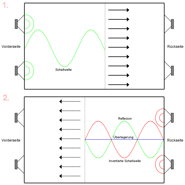

For these things to work really well, you need to precisely identify the standing waves. Use a test track sample.
You'll immediately notice the frequencies with high SPL. Note the frequencies and program the active thing. Another approach is to place phase-shifted subwoofers behind your listening position. They act like a vacuum cleaner against standing waves, but without measuring, this makes little sense.
basically use the double bass array for a clean deep bass.1688624574190 (1).png
Reactions: Lagonda
basically use the double bass array for a clean deep bass.View attachment 151802
