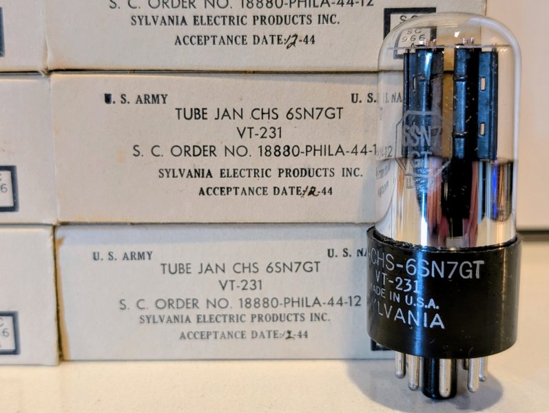

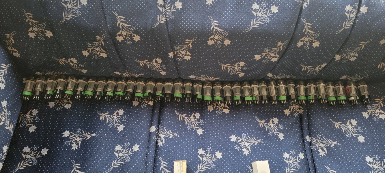

A lot of the tubes I purchased were tested, screened, and graded for noise and microphony by the seller. I can tell since the vendors had stickers on the tubes or the boxes; some used a small dab of paint on the tube.

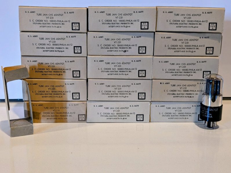

This set of 6SN7/VT-231 had no markings, so they probably were not tested when I bought them.
I put them on the Maxi Preamp and was amazed at the results. They all test between 5% and 10% over nominal gain, they were all matched within 5% between triodes in any given tube. Also, they measured at less than -85 dB for noise.
In other words, they were all matched. I suspect that this was a result of them being from the same or subsequent months of production. And, they were likely tested/screened by Sylvania for the military.
