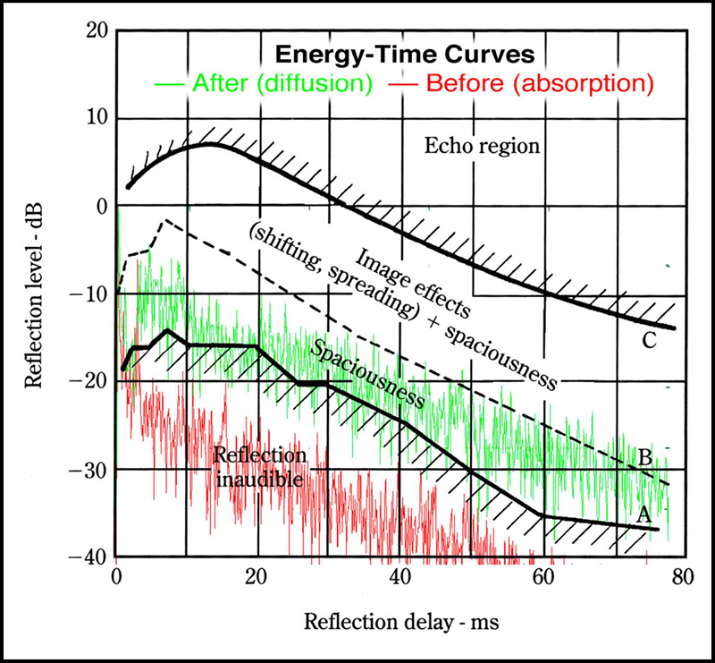

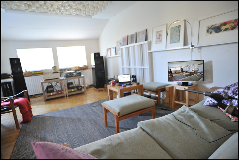

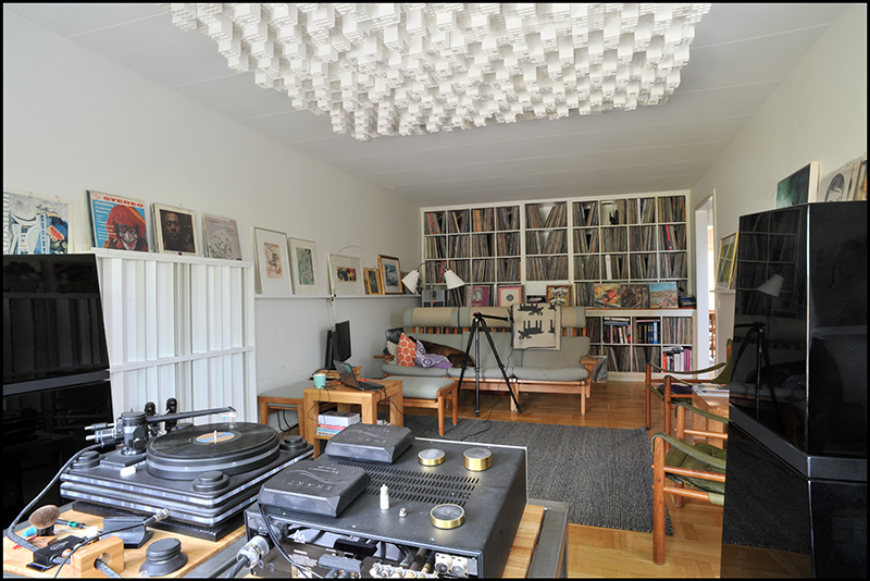

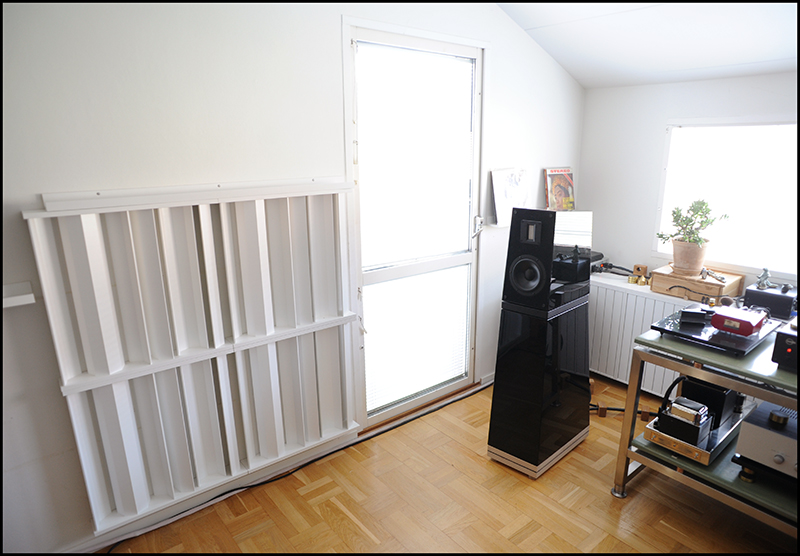

First sidewall reflections will hit 1.5sqm SMT Wing95 diffusion. These very narrow wing-elements measure 600x600x95mm and, like the other wing-elements, they not only diffuse but also variably delay first reflections.
Matts Odemalm developed the wing-elements to achieve a delay and evenly staggered energy distribution in the reverberation. Like the green curve in this example;
First roof reflections will hit 5.5sqm SMT Golden Horns.
The wall behind the speakers is treated with slot panels on 300mm depth and 50% absorption.
It is a soft LEDE concept with modest absorption in the speaker zone and quite live in the listening zone. I'm planning to see what happens when I increase the amount of absorption in the speaker zone. HH is probably better...

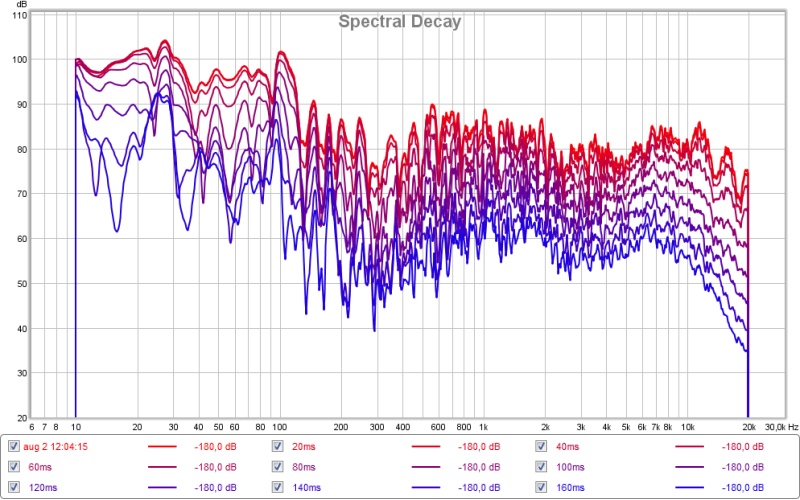

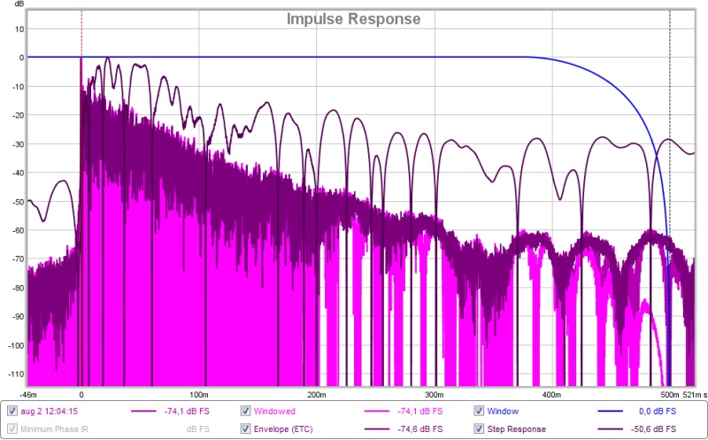

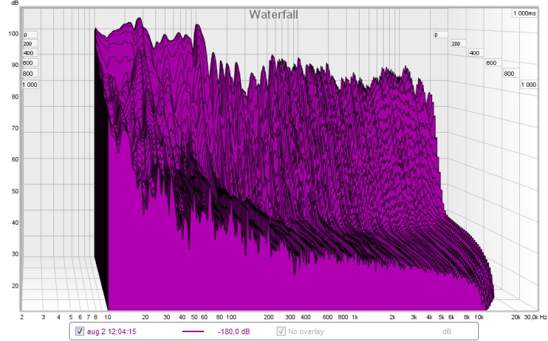

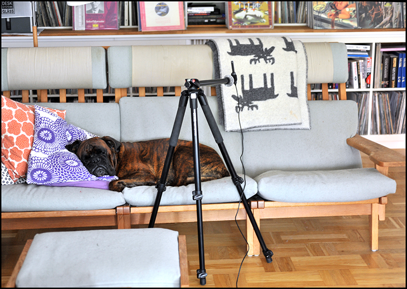

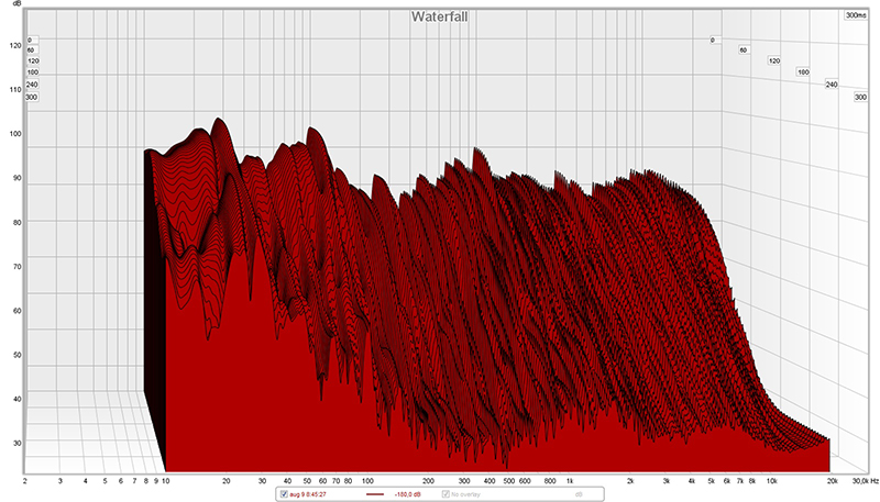

Here are some recent room measurements!
They are made with REW and a UMIK-1 microphone from MiniDSP.
REW supports the UMIK-1 and MiniDSP has a calibration text file for it.

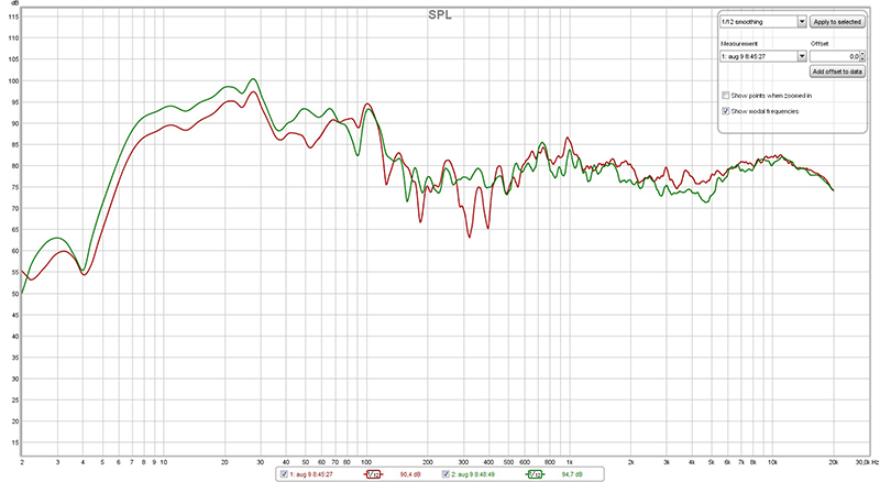

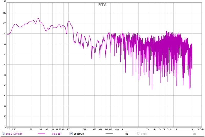

I did the measurements shown in the graphs above with both speakers at the same time. I think it may be better to measure left and right speaker separately, and combine the measurements.

Results from two separate measurements with REW (left and right channel).
The SPL diagram is filtered with 1/12 smoothing.
Ventilation and dog shut down.

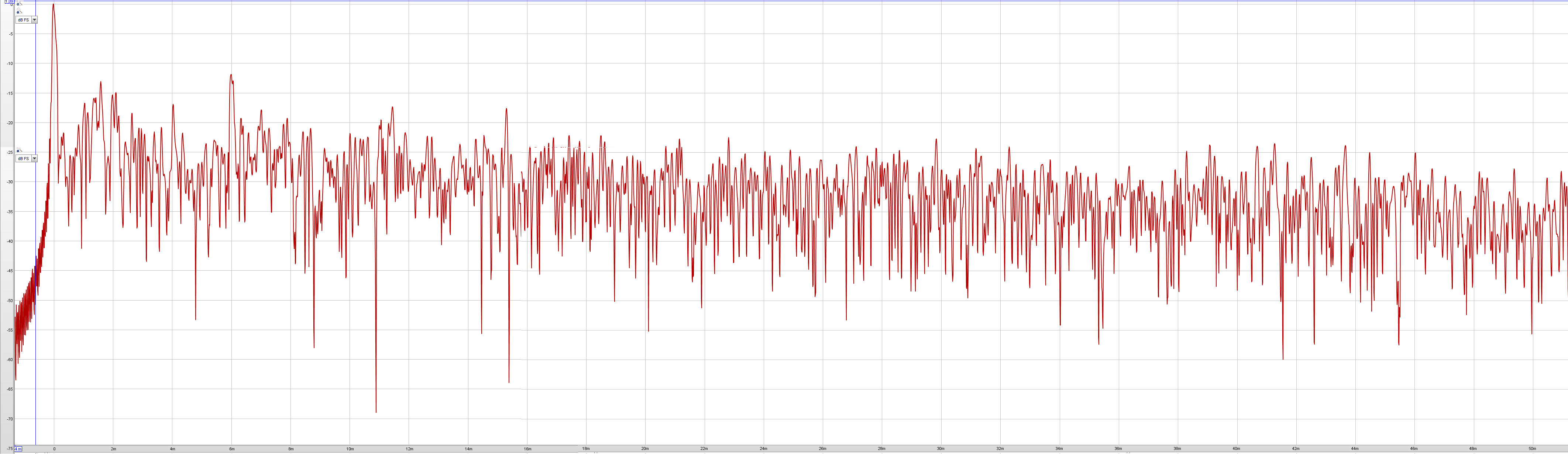

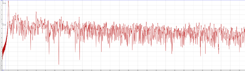

Here's a zoomed diagram of the ETC 0-50ms:
Clickable!

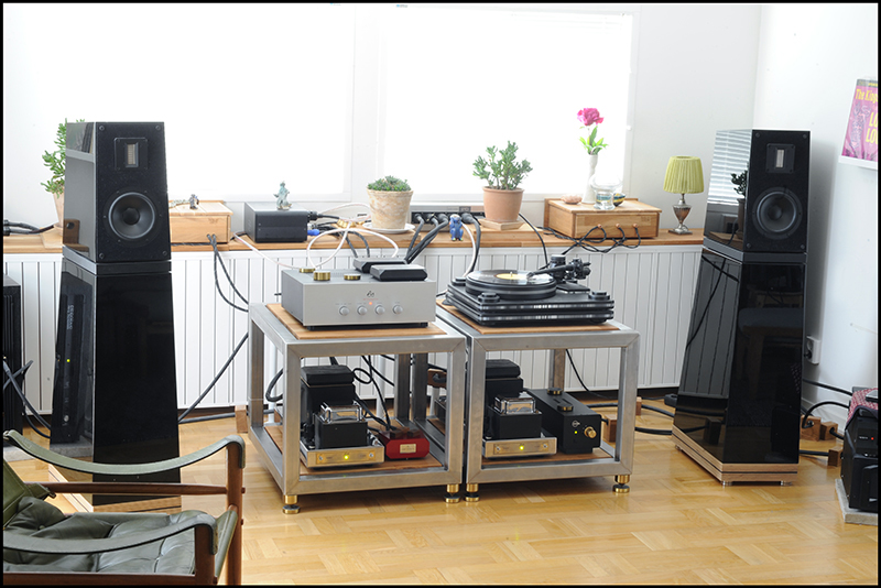

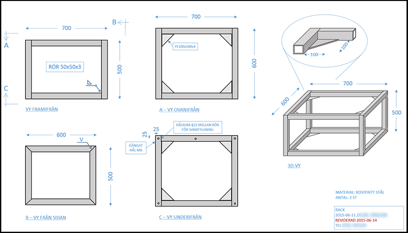

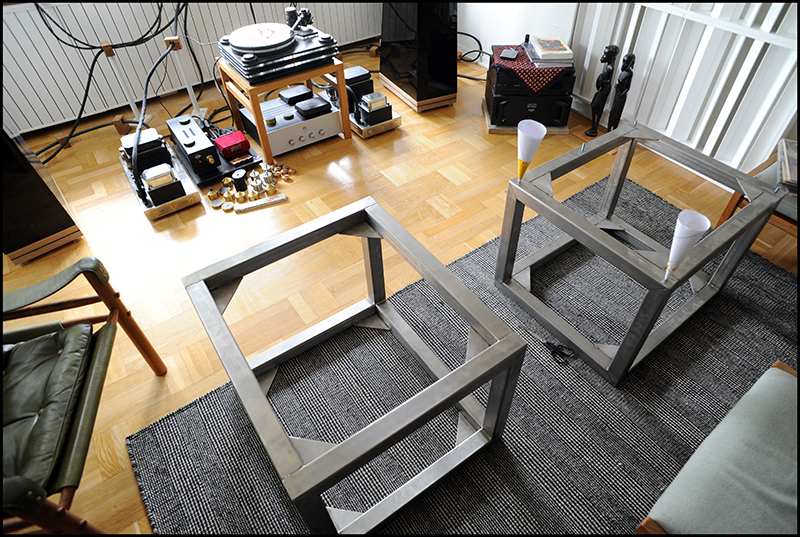

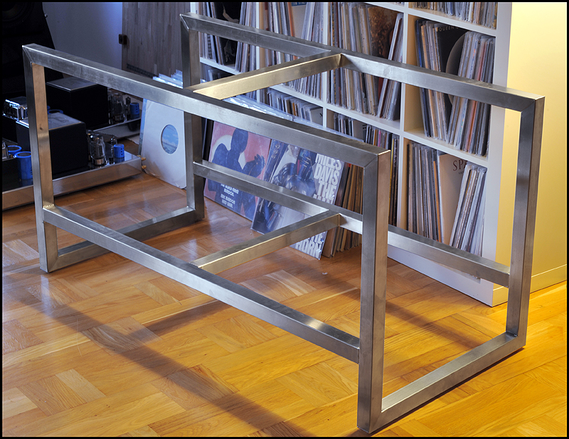

You have already seen the latest "prototype" if you visited the first page of this thread, and here are some setup pictures;

Did you hear Big changes after installing the new racks?
Hello Kim,
My previous rack was very good, so the differences are not BIG.
What I hear is more definition, like solid response.
But I am far from ready with this structure. The frame is extremely good, but the shelves are only temporary.
It's clearly underdamped now. If I play a silent groove and hammer on the floor, I here a distinct "ding" from the speakers.
I tested to put a 5mm Timbertech mat between the oak shelf and a BDR shelf and put the turntable on that. It was clearly a bad tuning, so that was removed.
I'm working on a composite shelf now and will post here as soon as it's ready.

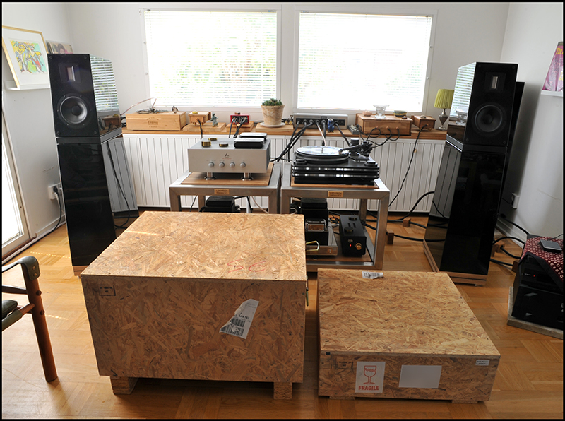

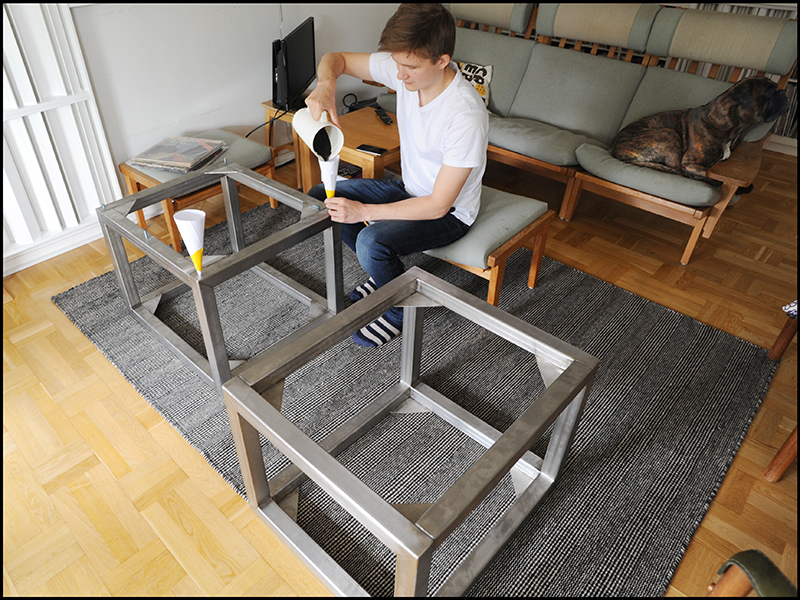

New coffee table?
Exactly! and a small stool for feet resting.
The table is heavy, and luckily I had a friend to help me move it in the house.
4Point must be demounted, and Stabi Ref lifted away and so I could turn the rack 90 degrees;
