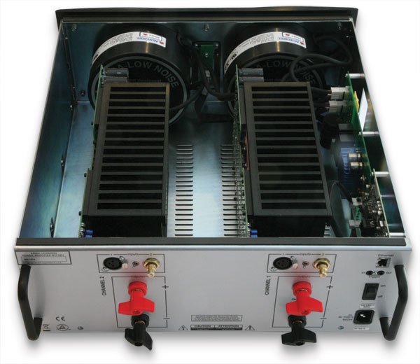

And I answered him in PM :). Just briefly for others, the H series is designed for high reliability and compact form factor so that you can get multiple channels in one box. Here is a picture of its guts (stereo version; monoblock is just one amp):

Comparing them to each other, I can get the H series to run out of power at lower levels than the 532. Bass gets thinner in the H series at levels where the 532 is still transparent. This is in a large space with someone who likes his music dynamic and loud at times :).
