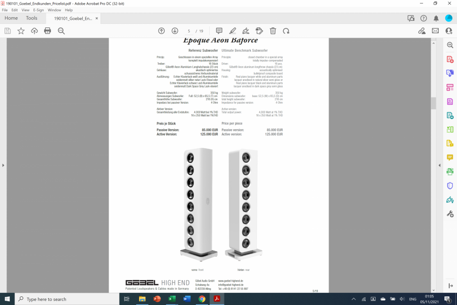

Of course, the Goebel Epoque Baforce tower sub (active) is Eur125K each! 16 x 8" cones (8 x dual-opposing in a single tower weighing 350kg or 770lbs). If the excusion of each cone is 'only' 2 inches, then the air movement of this is equivalent (I think?) to 2 x Wilson Thors.
