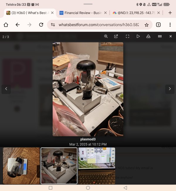

Steve, just to clarify, the seller offered me a small portion of the amount that I paid for both pairs. I refused to send them back for penniies in the dollar. I did send them back to Brent Jessee who confirmed that one pair tested unusable and the other tetaed poorly. Of source, the seller refused to take the tubes back for a refund claiming it was my issue. .@dminches ...I recall a thread by you in the past year where you received what you were told was a tube that's to be NOS and your measurements proved otherwise and you wanted money returned and there was a huge discussion as to what is proper. IIRC you wnted to keep the tube until your money was returned.

I imagined that is enough time for Ron to reply if there are more issues and he hasnt so thats a base to start off from . I have explained this all to him before and will provide screenshots - but as is sometimes ; ppl get emotional about their money and they want someone to blame.Thank you David

I have tried hard to work with Ron on this and have given him all the information i could. Unfortunately despite all the facts - he remains convinced it was my fault
The Tube was NOS and a messaged sent to Ron on the 2nd of Mar where using the Roetstor it measured perfect on both plates. The base was not loose when sent ( but more on that later) and the measurement was done after ( from memory; it was 4 months ago) at least a day of burn in using the tube burner that i use for this purpose to identify any issues well beforehand
Ron received the tube put it in and as per his reports with Laszlo's fine adaptor and the tube gave a flashand died
his message verbatim
Mar 14, 2025
Hi, I received the tube yesterday. I put it in my Horizon this morning. When I switched it on theire was immediate a bright light and it died. It looks like their was a shortage. Also my Horizon is not workng anymore… I hope the fuse blowed but I need to inspect it. Not nice… What shall we do? Shall I send it back?'
Ron's message above makes the points
A. He mentions foot but he really means base - base is loose . Foot is the Pin Ron and base is the bakelite part the black part not the pins which is the silver parts
B.Foot loose = questionable tube
C. That I claimed it could be the problem with the adaptor or the horizon and that the horizon was damaged by the tube
D. Not fair of me to blame others
E. Refused to send back tube and adaptor when you asked for it
I will address it in these sections . Anything else Ron before i start ?
