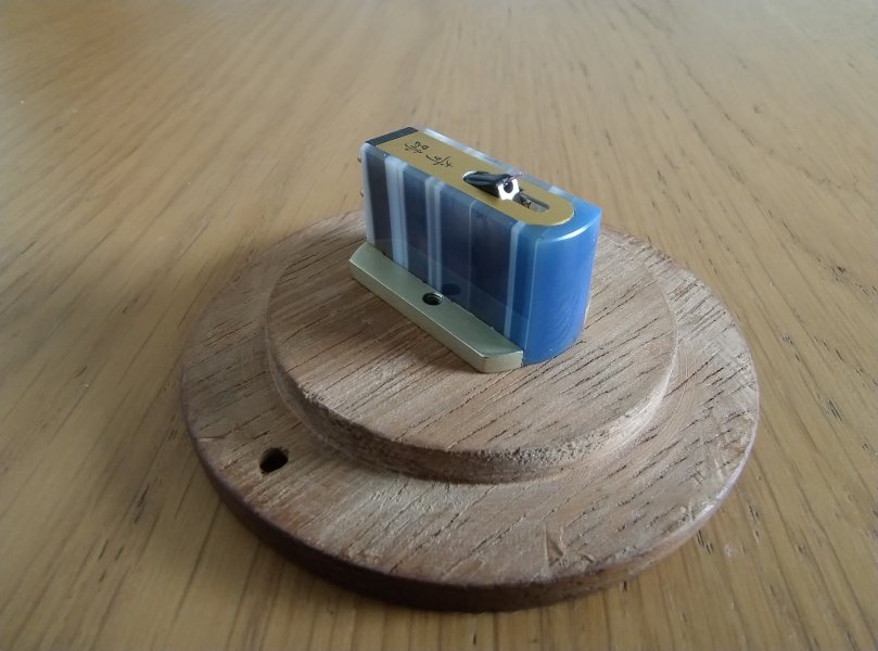

I have been dealing with Koetsu's for 40 years and I never seen
a tilt like that in the back and I have mounted or seen dozens of them.
If that was a rebuild it was done wrong,I would make them redo
it.If it was a new cartridge have it checked out by the new
Koetsu makers.
That picture looks ridiculous.

Note that I could have just mounted this cart without any shims in a traditional eyeball-mounting approach using a protractor.
When sending in a cart for microscopic geometry analysis, this is what we get...
I´d never accept a cart like that.......totally unsellable too IMO

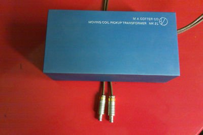

For me a perfect match mitch cotter mk 2l 1- 6ohms gain 26db koetsu.

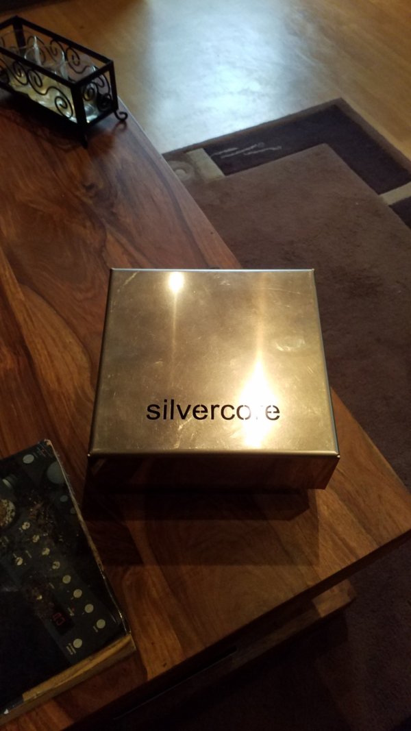

For kiseki mostly high-impedance MCs, I would recommend a Silvercore Pro SUT 1:10. It plays very cleanly and is highly dynamic, resulting in a great synergy for me.20250627_145700.jpg
I use them in all my DIY phono preamps. Neutral, no coloration. Cartridges already produce enough coloration.
The cartridge you are discussing is a 15k cartridge

So, looking at the compensated Blue Lace, that looks like the azimuth must have been badly skewed as well, the inside rear edge of the stone body is almost contacting the record surface! Add that to the fact it’s supposedly still 9 degrees off as far as VTA? That would drive me up a wall. A refund or perhaps a recommendation of a new cantilever/stylus replacement would seem to have been the best course of action vs an adapter that doesn’t fully correct the problem IMO.
The azimuth is only 0.9 degrees which the average of most cartridges (well 0.86 degrees by my database). You will be very unlikely to get a refund/repair on SRA/VTA specs due to their angular error because the industry doesn’t index these angles to how lacquers are actually cut. Claims for egregious zenith error (past +/-5 degrees for most stylus profiles) or crosstalk are more likely to meet with repair/refund.
