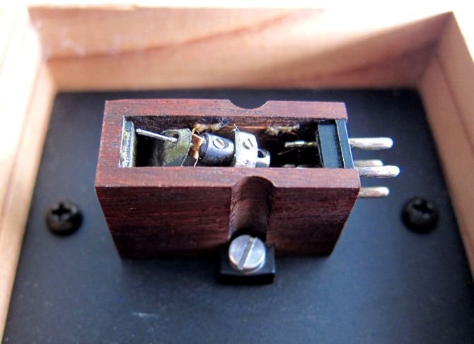

If i zoom in your photo, it looks like the system has sunk into the back of the stone case. I'd would checked by a retipping service. Perhaps the adhesive or fastening has come loose. The cantilever angle no longer fits the case. Example: other koetsu11149385_526578580813457_105081279217013739_n-2.jpg

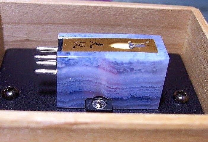

There's no way the motor can move back on its own. It must have been installed that way. I think it should be OK, though the cantilever angle on that Koetsu is indeed a little steeper than average. Beautiful Blue Lace Diamond you've shown, though!

Other models are held in place with a screw. However, I would have it checked;)

If i zoom in your photo, it looks like the system has sunk into the back of the stone case. I'd would checked by a retipping service. Perhaps the adhesive or fastening has come loose. The cantilever angle no longer fits the case. Example: other koetsuView attachment 158571
I absolutely refuse to believe this is how it´s supposed to be, whatever anyone claims
sometimes it is quite simple, handwork always involves a certain amount of error.
is not aviation technology where human lives depend on.
The worse part is people are paying some of the highest retail for a product with poor QC, high rebuild costs, and poor sonics, just because of marketing mystique. I would almost rather have digital than play koetsu.
there must be some form of qc at that price level
a Japaneese craftsman would bow his head in shame....
Perhaps not. They don’t respect the vertical modulation angle of a Neumann cutterhead or a Westrex and so on. However, Koetsu is hardly alone in this. When more consumers can hear for themselves what they are missing because it is more expedient to build a cartridge with high VTA than to have it agree with cutterhead vertical modulation angles, they will ask for the changes in design and tooling from manufacturers. Until then, “we” won’t know what is being missed until we hear it for ourselves.
No Stephan, you are wrong here and you know it. I don’t buy your claim a bit, sorry pal !
There will definitely be one qc, but no one knows what happens after delivery. The housing and generator are adjusted by hand, as they are not machine-made. Normally, the cantilever is aligned at an angle of approximately 20 degrees to the LP, so that the customer can position themselves at the lower edge housing parallel to the LP. is the diamond not be perfectly ground or glued? You must be able to achieve this by rotating the generator. Koetsu does this by adjusting the angle of the generator to achieve an SRA of 92°.20250926_160920.jpg
P.S
I've disassembled many DL 103s to use them with different housings. You wouldn't believe how difficult it is to get the perfect angle by hand and fix it.
There will definitely be one qc, but no one knows what happens after delivery. The housing and generator are adjusted by hand, as they are not machine-made. Normally, the cantilever is aligned at an angle of approximately 20 degrees to the LP, so that the customer can position themselves at the lower edge housing parallel to the LP. is the diamond not be perfectly ground or glued? You must be able to achieve this by rotating the generator. Koetsu does this by adjusting the angle of the generator to achieve an SRA of 92°.View attachment 158592
P.S
Out of the last 24 Koetsu carts I have analyzed, the average VTA (dynamically measured, level head shell) is 27.2 degrees with a standard deviation of 2.6 degrees. Their SRA is much closer to 92 degrees (yet has almost twice the standard deviation as VTA!), but I remain inclined to believe rake angle is not nearly as audible as VTA - by a long shot - though the evidence we gather in this effort next year may cause a shift in this position.

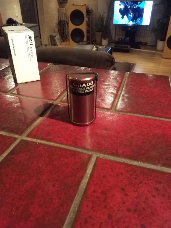

I once had a Grado, but the factory-made stylus suspension was too soft and it didn't play cleanly. The exchange went smoothly. Johan, sometimes you get a Monday machine (and that doesn't just apply to cartridges). You can't accept that. You're expected to do good work for your salary.20210215_195505.jpg
I hear what you say - but I still don’t buy your claim I did comment..

I once had a Grado, but the factory-made stylus suspension was too soft and it didn't play cleanly. The exchange went smoothly. Johan, sometimes you get a Monday machine (and that doesn't just apply to cartridges). You can't accept that. You're expected to do good work for your salary.View attachment 158604

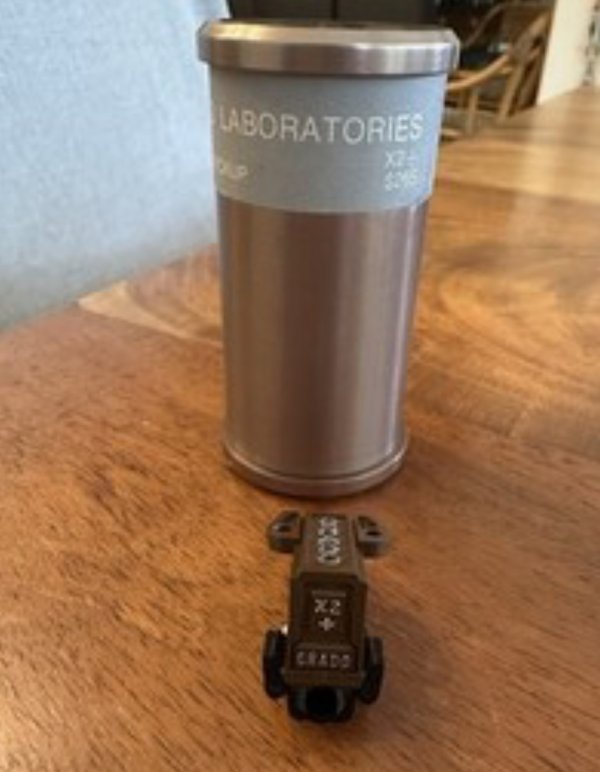

Boy does that Grado cylinder bring back memories. Had an X2+ I bought in 1988 I think, that came in the same container with the elastic band to keep the lid on. It was a great cartridge on my Thorens TD318, but it chattered badly on a Technics SL1200. Had an amazing sound.IMG_9863.jpeg
