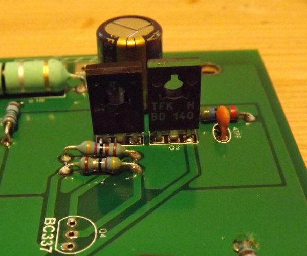

The drive transistors BD139 na BD140, see there orientation and the BD140 is on the right. Solder them closed as the PCB acts as a small heatsink. Also mount the BC337 close but not tight to the PCB.

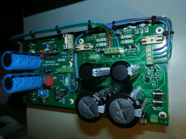

Here is a completed one channel with the additional add PSU circuit board

All four PCB required for the super charged version.
