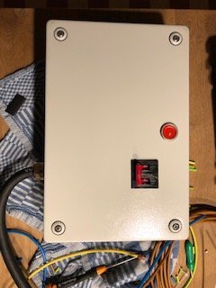

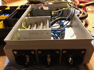

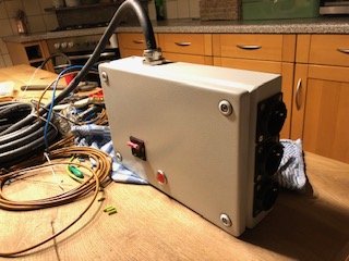

Has anyone used balanced isolation transformers provided by Toroid Corporation, located in Maryland? They offer transformers in enclosures.
Currently I am working on having my dedicated audio power supply upgraded to 10 AWG and ending in a 6x furutech box at the audio system.
Secondly I received the isolation transformer (3kVA) this week and will connect this soon at the incoming side.
I am going that direction after doing several listening trials with 2 older 1.5kVA transformers, connected as balanced (without shield/screen) and the difference was substantial (for the positive) with the transformers.
From the furutech-box, the SET amps are directly fed as well as the tube phono-pre. The rest, mainly digital is going through an IsoTek.

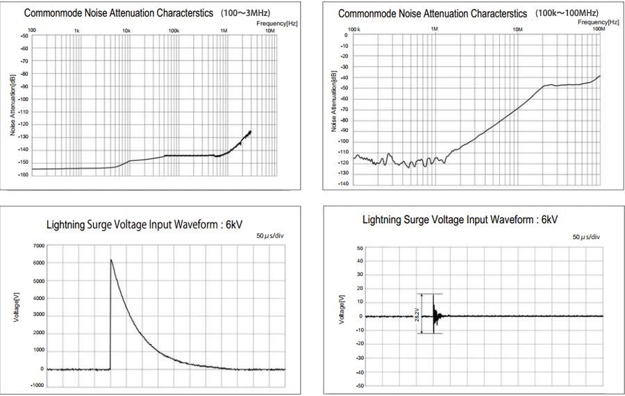

I don’t remember the exact source of this information, but FWIW, it was from a North American toroidal isolation transformer manufacturer. Note the first graph - most relevant for audio. Basically obliterates common mode noise on the AC line. The graph to the R also says “common mode”, but I suspect that it’s a typo - it should read “differential (normal) mode”.
I wished that “power conditioner” manufacturers would be more transparent with the objective data / measurements of their products and provide more graphs like these!
