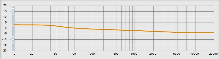

Let's look at an example where DSP can optimize a system.
Speakers get reinforced in the lows by the proximity of placement to surfaces. If the speaker is placed closed to a corner with solid walls, it can pick up as much 9 dB extra in certain areas of the bass. If it's placed close to the wall, the extra SPL is around 6 dB. If the speakers are placed far out from the walls, there's only the gain from the floor. 9 dB and 6 dB less compared to the previously mentioned placements. And if they put somewhere between, there's a reinforcement of SPL somewhere between these numbers.
Besides, if there are windows or light walls in the room, the extra gain by close placement to the surfaces becomes less.
When a speaker manufacturer tunes the lows of speaker, they have to choose what extra SPL they will go by. In other words, your speaker works only the best with a certain gain from the boundaries. But the placement you choose or the type of walls you have may quite different. There's no way the manufacturer can tune your speakers or subwoofer for that matter to work optimally in every room or with different placements. So in many cases you will either end up with too much level in the lows or to little.
This is however, easily tuned correctly in by shelving in a DSP. We can lift or lower the lows to achieve either a correct or desired tonality:
The same goes for the highest frequencies. The treble will always fall in level on distances. If you sit close to the speaker, the fall in SPL isn't much. But if you sit quite far away, this loss of SPL in treble will increase. And again, a speaker manufactuer can't choose one setting that fits them all. They have to settle on one setting, which may not be the optimal tuning to the distance you listen too.
DSP can also be used only in a software, with no physical hardware added. For example one could use Roon. But obviously one should ideally measure the result to see what's changing. By both measuring and listening, one will learn what works best for you. The optimal setting in one room can be different from another due to how the time domain behaviour is of the room. Or the bass of your speakers will also matter here. Smaller woofers will have their limits to the level before audible distortion kicks in. Your musical preference will also play a role.
