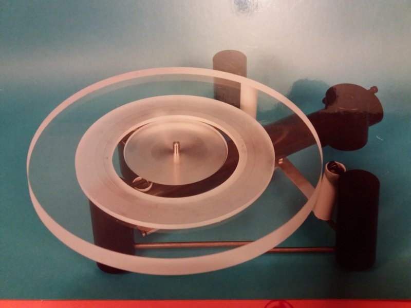

The only way the base of the arm support and the surface of the platter can vibrate in the same way is to place them on the rod.In this case, the whole thing resonates in only one direction, not three as with any plate shape.I am attaching a picture of a turntable that I made about 40 years ago. It was a very good turntable.
Musical instruments made from rods. Vibration can be in different phases along the length of the plinth, the plinth must be rigid and dead. There also needs to be mass, since the more mass the harder it is to get it moving. That is why our plinth was machined of solid aluminum 3/4" thick.
Solid aluminum 3/4" thick plate resonates like hell in all directions! I wrote a nice example above of what the solution is. Probably no one imagines what little things affect the sound of a turntable.
