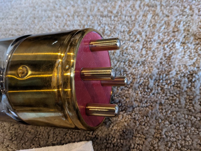

You could always try Flitz on one of the bus bars to determine whether is gives that kind of glow. Then go over it with the DeOxit D and G.
A few years back, I used Flitz to clean and shine some large sheets of copper, it worked amazingly well. Any time I use it to clean copper AC plug blades, they look shiny as new.
But even when it is clean, as soon as you touch it, the oils from your hands will start the tarnish cycle anew. Gloves will help.

PXL_20201122_210058115.jpg You could always try Flitz on one of the bus bars to determine whether is gives that kind of glow. Then go over it with the DeOxit D and G.
Tube pins after cleaning with Flitz --
