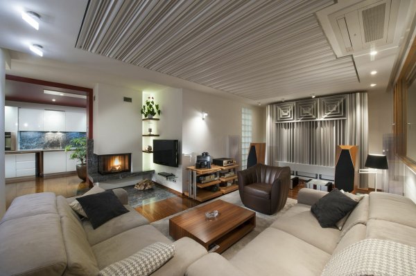

Seeing the photo of flyer's SMT room in another thread, I would like to share with you two pro photos of my room that better show the beauty and high WAF of SMT treatments.
c2IXvaquo3JnyCPsB1dl5_TIkHIN1pc2n8NJBBw274Q,hZ5iC4TkMXgri5D8lSM5TC4HVOcng7BV3cb0vNH95Lo.jpg
ELQ0wzEl9FFefWcZQHmSkU8avum2K4XQ1EhxYeZkMR8,S7X_vVePJY5au7M12PVuVrtcLPlPpNWZPznF5B_lrv8.jpg
Now it looks trully spectacular ! Wow.
Hi Marcus, is that glass on the right? Does it not cause any sound reflection problems?
Beautiful design and installation , simplicity and class, congratulations.
Yes, that are custom made, triple glazed Internorm windows and on the second photo, above them in the slot you can see stacked Hunter Douglass honey comb (Duete) cellular shades. I made lots of experiments with them - all three lowered fully, then 50%, 30%, 20% and combinations between that and frankly, I don't use them often because the sound then becomes more or less dark and closed in. On the other hand, transparent Wings (left and right from speakers) work just fine and there are no problems whatsoever with reflections.
