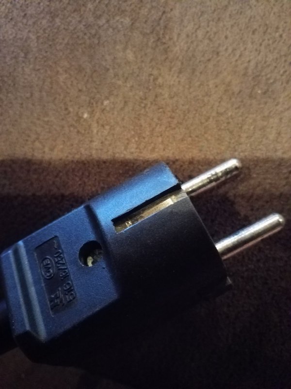

Do you really hear a big boost with reapplying every 6 months.
I'm a smoker, I have to clean it often, the nicotine creeps in everywhere. I think once a year would also be enough pure silver plugs do not oxidize so quickly once they have been cleaned with them. You can hear this very clearly with the tonearm wiring, the dynamic increases and the background noise level is lower. I haven't measured it yet, trust my ears. I will use it permanently, I am convinced of it.
