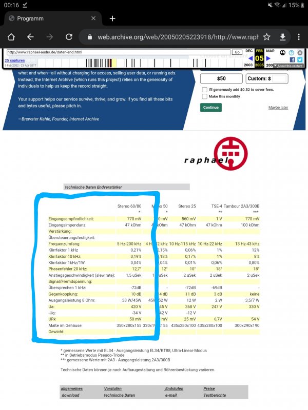

When i need more power, i use my diy kit amp stereo 60 from audio workshop from 90ties push pull el34 in triode mode 17watt. Amazing transformers, low distorsion and a good damping factor 20211217_002213.jpg
No set amp i build or owened had that amazing sound.Screenshot_20211217-001631_Chrome~2.jpg
I recduce global feedback to 5db runs stable
