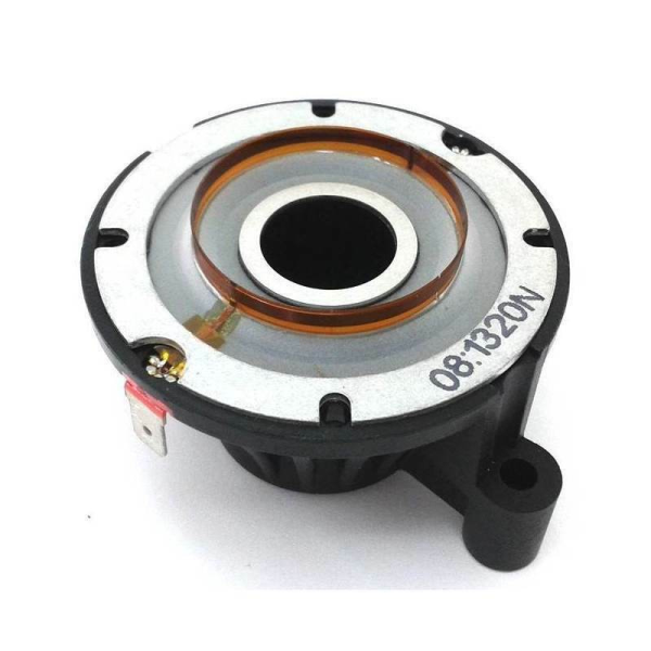

I am curious which 1 inch compression driver Odeon use in the Semper. Do you have any info?
Thanks
I don't know the brand. All I know is it is 38mm mylar ring radiator with Nd magnets...maybe BMS? If so, the BMS 4540 seems the likely candidate...
The only commercially available 38mm Mylar annular diaphragm is this one (B&C):
