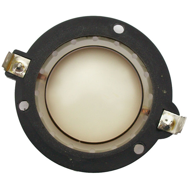

I would not really go much below that with a 1 inch compression driver either. The one I use (Beyma CP350Ti) I cross at 1.8Khz. The 1.4 inch throat driver I use (Beyma CP750Ti) will go down no problem to 800Hz (it is a 3 inch diaphragm). Both will play ear bleed levels with 1 watt.

I am curious which 1 inch compression driver Odeon use in the Semper. Do you have any info?
Thanks
I don't know the brand. All I know is it is 38mm mylar ring radiator with Nd magnets...maybe BMS? If so, the BMS 4540 seems the likely candidate...
