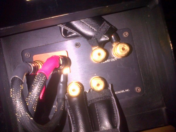

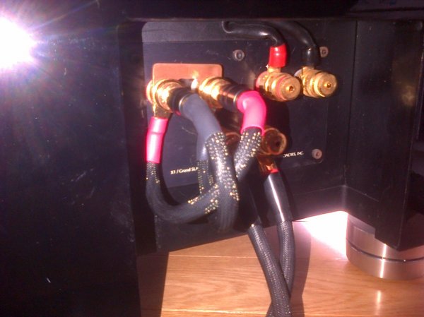

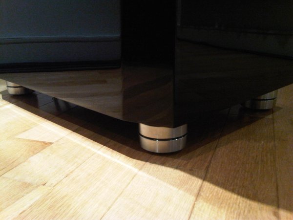

OK Gents, here are 3 photos of improvements I have made to my X1s.
1. Ultra 5s in lieu of Wilson spikes
2. Entreq Vibb X mass damper on top of upper modules...really helps still images, gives upper range greater alacrity, freedom and air
3. TA Ref XL jumpers IN ADDITION to the 1/4" thick copper jumper plate...substantial improvement in bass detail, articulation and 'nimbleness'...but surprisingly far better, clearer mids/upper treble extension and detail as well...a far more capable transducer under complex orchestral

What are the jumpers connecting? I can see the speaker cable on the bottom and the right seems like it's going up to one of the modules...
Let's see a pic of the whole room :)....we can never be satisfied :)...
There are 3 sets of binding posts...the lower middle ones are obviously to the main amp. The upper right is apparently the crossover to the upper modules. I am told the lower left is bass crossover/module. as you can see, there is a copper plate connecting those 2 binding posts to each other...its about 2 inches long, maybe an 1 tall and 1/4 inch thick.
there is a guy who owns X1s and has basically bi-wired them to his ML33 Ref monos...and found the improvements to be so dramatic he says he declined to go with the Wilson X2s when he said he auditioned them in his system. I have spoken with a few people who were encouraging me to bi-amp these but that involves removing the passive bass crossover...not for me.
As for the X1 owner who wrote that he prefers his X1s bi-wired over X2s...I was skeptical, but certainly felt it was worth experimenting with a jumper (not bi-wire) since I had a pair of TA Ref jumpers from my old SF Guarneris. He said the X1 'melts down' in comparison with X2, if not bi-wired. But bi-wired, he prefers the X1.
After I put my jumpers IN PLACE of the copper plate, I lost a good deal of dynamic attack and realism...but liked some of the more natural overtones of mid-range notes. but overall, it was inferior...so I put the Wilson copper plate back but ADDED the TA Ref jumper cables and that was the start. You could immediately hear all manner of benefit from vastly more articulate bass, greater separation in mids...and generally the speaker seemed far more composed under the duress of large scale orchestral. Except the 10-yr old TA Ref was showing its 'voicing of old' where the upper treble and extreme transients were just ever so slightly softened.
Now with TA Ref XL MM2 (latest generation) jumpers it has made a huge-I-a'int-going-back kind of improvement. Stunning all around...

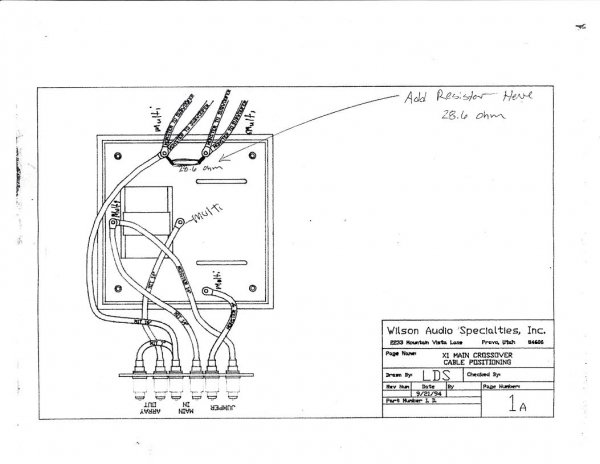

You have been experimenting with the effects of replacing the solid Copper jumper on the Bass jumper terminals, augmenting the Copper plate with Transp Ref Jumper Cables. I've been reading with allot of interest back in post #9.
When I took out my 12" woofers for re-foam I decided to flip the Bass cabinets upside down and check to see if the Bass ballast resistor was there and check on the value of. Relatively easy to get to once you have the Bass units flipped upside down. So everything as expected per Series V upgrade directions.
But; the reason for my post here is: I thought you would be very interested to see the attached diagram which shows where the 3 sets of input terminals on go.
This picture was included with the Series V upgrade directions. (Debbie: I hope I not violating any Wilson Audio protected documents)
Maybe this helps you with the quest determining the best 'copper plate' method ?
Let me know what you think.
Bill

Thank you! Fascinating...much appreciated. I have had to determine what's best 'by ear'. So far, I have decided that keeping the Wilson copper bar and ADDING Transp Ref jumpers is best...and have just agreed a deal to trade in my old jumpers and buy TA RefMM jumpers (their highest level) after comparing my Ref jumpers to the latest RefXL (which were clearly better). I am not sure technically what the diagram would 'translate' in terms of what I am doing...all I know is, I prefer it.
And interestingly, the Dealer had independently decided to order 4-5 sets of TA RefXL jumpers to use on every jumper for their Focal Grande EMs...there are 4-5 jumpers I think. When I came to them with my observations after having tried my jumpers at home, they had already been experimenting with the big Focals in their demo room.
