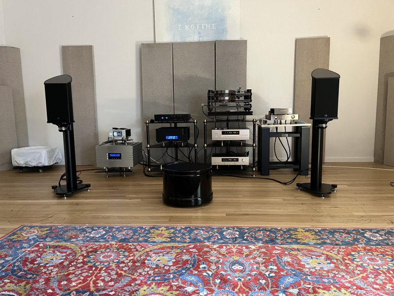

Hello everyone. This is an old thread but for completeness I will add my two cents for those that may acquire a used WB torus infrasonic generator. I do not have experience with other subs, as I was fortunate to have full range speakers most of the time. I bought the WB Discovery II when I was working in Dubai and I was living in a small one bedroom apartment. The torus was a later addition. It definitely added a lot to the Discoveries and transformed the system all together. I tried with 2 units, but I found that one was more than sufficient for a 1000 sqf space. Thus, I only kept one unit. Regarding various questions on the settings, I would like to add:
1. You can connect in a two channel audio system 3 ways: RCA, XLR and through your amp's speaker posts, provided that your amp can handle it. Not all amps are capable. Please check with the manufacturer.
2. If you have an AV processor as well, you may use one of the connections (RCA/XLR) or the "High" for your AV and the other for your 2 channel audio. You can use the gain and frequency settings for each separately. Depending of the source, the torus will roll off accordingly, based on your setting.
3. For my Discovery II, which is used exclusively for music, I have taken from the preamp's XLR out and feed the torus amp. In my case is not blended, but from what I know the bass under 100Hz is blended in most recordings. The frequency is set at 45Hz and the gain at quarter to 12. Therefore, the torus covers 45Hz and below.
4. I have not noticed any difference using the high or the low input. If you have the cables, the high is blended L/R, thus you have the entire recorded material. The same is true if your preamp has a sub out.
5. Underneath the amp you may set the EQ roll off. I have set it to 30Hz. In my experimentation, at 25Hz and 30Hz it is the fastest response. I have gone with 30Hz, as the music material I use, rarely goes below that level. At complete bypass, it was booming a bit in my room.
6. The phase is set close to "zero" because the torus is set in the middle of my speakers and 10cm (4in) in front of the monitors. If different location, the phase setting may need to be adjusted.
I hope this helps a little from a practical standpoint.
Take care, Basile
