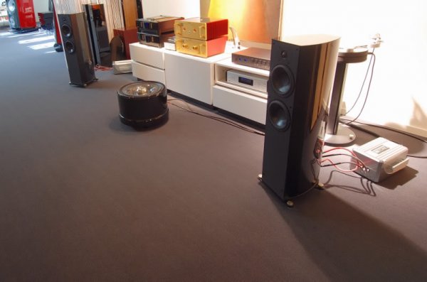

I had the opportunity to listen to the Torus at an event at Audio Concept store in Stockholm (and feel) and the bass was incredible tight and exceptionally well integraded with the floor speakers (also WB). Below are some picture threads from the event when Craig Milne demonstrated (constructor and founder of WB) the Torus. IMHO, the WB Curve with Torus was not far from the big Focal Utopias performance.
http://www.euphonia-audioforum.se/forums/index.php?showtopic=7210
http://www.component.se/docs.php?id=75
