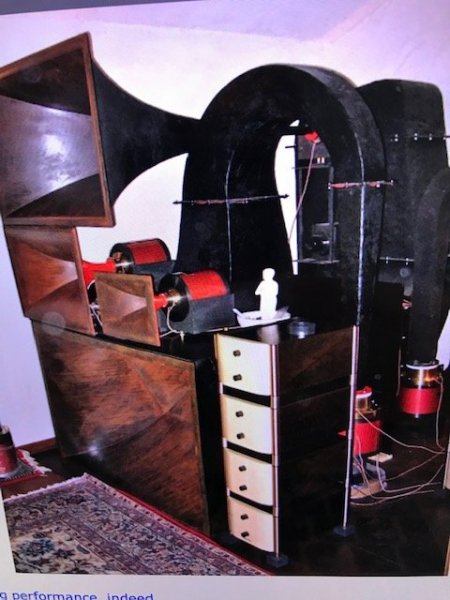

So you don’t need to use a compression driver in the bass to horn load the bass. For instance, the horn loaded bass cabinets from Altec / WE etc invariably used the 18” or 15” paper cone (field coil or Alnico) drivers loaded into huge horns - you probably have seen photos from Munich in the past.
There are very few instances of actual bass compression drivers let alone installations. The few companies mad enough to make them are for instance ALE and Goto. These ALE bass compression drivers employ gigantic magnets and weigh ridiculous amounts (100kg+). There are some mad men who also front load these in 9metre front loaded horns lol.
The only speaker I know commercially to use them is that mad new multi-way horn with multiamp and dsp. See attached.

Some compression bass madness:

I Listen many times Ale speaker with ALE Bass Horn with develop of 9 mt and DEP 160 driver for bass weight more than 100 KG,system first 4 way and then became 6 with against 4 way with always DEP ALE driver but woofer ALE W 4000 in carbon block box.
The bass with the beautiful ALE W 4000 was very good but was a toy against Bass horn with DEP 160

Hi Gian,
Is the ALE DEP160 the massive 160kg+ bass compression driver?
