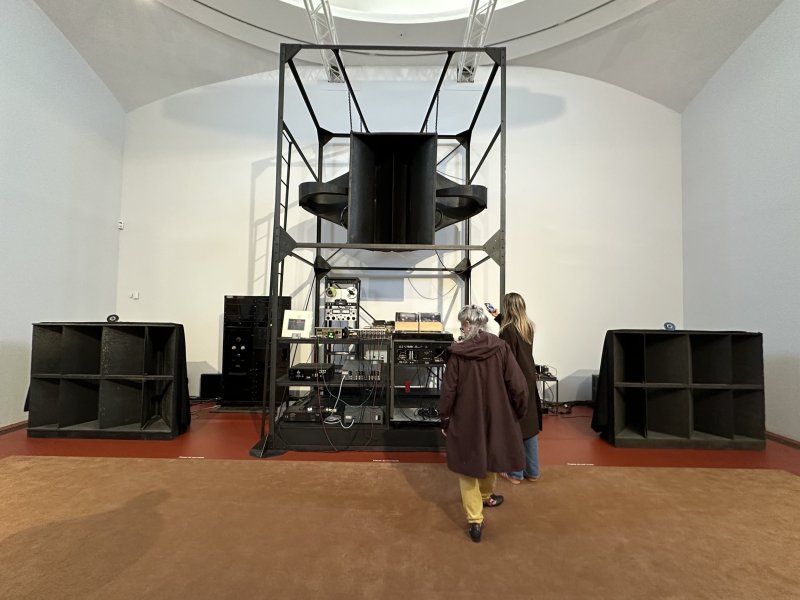

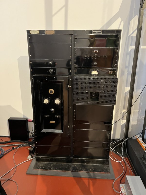

Visited the Serpentine Gallery today. Listened to Klangfilm and WE albeit at low volume but it sounded wonderful. Worth a visit for the art too.

And a couple more for you General.IMG_8358.jpegIMG_0160.jpegIMG_0159.jpegIMG_8362.jpegIMG_0154.jpeg
