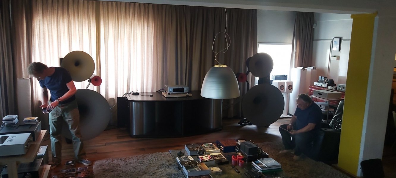

What color are the trios in the video?Audiolife Buren Avantgarde Acoustic Trio
