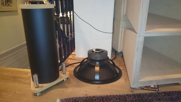

Hi,
What is the cut off and geometry of those horns? You are front loading 2 x 15” woofers in there
throat 20x20cm
mouth 70x40cm
horn length 87cm
rear chamber internal measure 40x40x22cm
they´re now "ventilated" to balance pressure in rear chamber with pressure in horn
pre ventilation I had a reflection in the horn@130Hz, which now is at 30
with 2220B 16 ohm from JBL Bonzo is spot on sensitivity about 110db
max excursion of the pair @1watt is 0,3mm so always linear
acoustical rolloff is about 50db/oct from 75.....lopass in this setup is about 550 12db electrical....24 db acoustical
my horns have cavity for sandfilling, but never dared/needed as they´re heavy and dead enough as is...

Leif, you don't like them open at the front?
DaveC
Nov 16, 2014
3,899
2,142
495
they re open at the front......the last pic is of the rearchambers with filterbox on top
Looks good!
Have you tried ports vs resistive vents? Or a combination, like a stuffed port? Does the current setup act like an OB with cancellation to the sides?

Is the sub on the right a tapped horn?
no it´s a 4 m long 1 fold horn designed by Rune Skramstad with a ventilated rearchamber
bonus with vented rear chambers apart from more even impedance is that it basically acts a a dipol with respect to room, so all bass problems from previous BR bass towers are gone..

sub horn build details and DIY acticve lopass-filter inc eq boards
