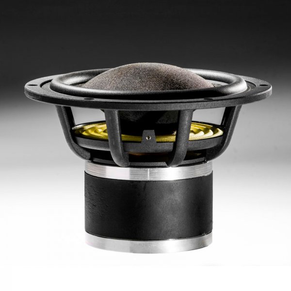

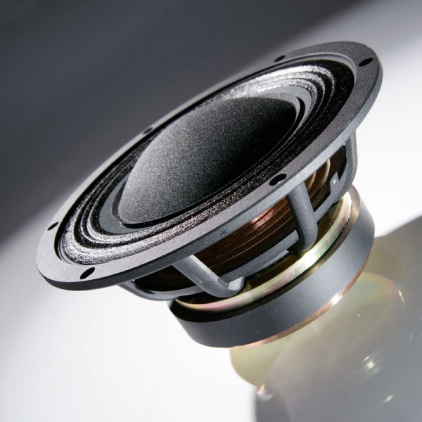

Hi Sami,Having the throat smaller is better and mine also is. Here is the detail of my throat. It drops down to that size but I still use the supravox 285-2000 alnico. The dust cap of it is also taken off... There is also reactance annuling that I have done by adding slices to mid-bass back chamber and measuring the impedance and finding the perfect balance. Altogether, this way the midbass sound much more fuller and gives a better response.
Haven’t heard the field coils but the Alnico ones are superb . Speaking of OB, I heard Suoravox’s own OB speaker, which uses 2x the 285GMF model per side and sounds excellent with a lively and punchy sound...a real alternative to horns...but it is quite wide to get good bass. The 165GMF is probably one of the better 6 1/2 inch drivers out the with 96db sensitivity and their 1 inch metal dome tweeter sounds sweet and airy. I am sure those 40cm woofers are good given what I have heard from this brand.Hi Sami,
I have been considering the Supravox silver coil field coils (as 2x15 inch woofers a side in a 2 way OB with a coaxial CD horn above and then OB subwoofers running with 4 x 15 inch per side). Had you thought about using the Supravox field coils as an option or heard of any feedback on experiences with using these over using the alnico Supravoxs.
