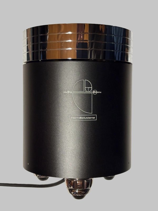

The Q" Drive - Now Available Separately!
We're really excited to announce that the outstanding belt-drive system from our "The Q" turntable is now available as a standalone upgrade for almost any mass-loaded, belt-driven turntable on the market!
Some more informations.
Achieving perfectly constant rotational speed is critical in a turntable - and this is where we try to set a new benchmark.
Instead of conventional control circuits, we use a quartz-locked PLL that maintains speed with the precision of a Swiss chronometer. A highly stable quartz oscillator serves as the reference; any deviation is corrected smoothly and without jerking.
At the heart of the system is a specially developed slow-running, high-torque motor with sintered plain bearings that operates virtually silently. Drive is transmitted via a premium round belt to an exceptionally large 16 cm diameter, 1.6 kg solid aluminium pulley.
Why so large? Simple: at 33⅓ or
45 rpm, conventional small pulleys (~1.5 cm) produce motor frequencies of 11-15 Hz. Their harmonics fall squarely in the audible range (22-111 Hz) and audibly colour the music. Our 16 cm pulley lowers the fundamental frequency to just 1.11 Hz or 1.50 Hz - even the 10th harmonic remains inaudibly below 15 Hz.
You also gain three decisive advantages:
  • Pronounced flywheel effect for silky-smooth, stable rotation.
  • Dramatically larger belt contact area (16.75 cm vs. ~1.6 cm) → virtually no slip and significantly higher torque transmission.
  • All the smooth power delivery that direct-drive and idler-drive fans love - without their typical motor-borne disturbances.
The motor pod and pulley are meticulouslv enaineered for
maximum resonance suppression and outstanding internal damping. Clean, low-noise power is supplied by an external power supply.
The outcome: a drive system that doesn't just perform brilliantly on paper - it lets the music speak in its purest, most unadulterated form.
nice motor unit but those legs are just bling and totally useless IMO
bought some to isolate my Melco from the rack shelf and there was absolutely NO effect
Thank you for letting us know about this product, Sven!
Is this intended to sit on a plinth? Or to be located near the existing plinth?
