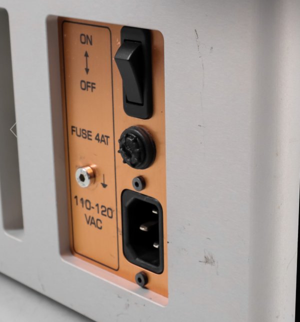

May I ask for your advice?
Where should ideally be Live, where Neutral at the IEC pins of the Taiko Extreme ?
Cheers, Ulrich

There is a dedicated ground screw already, you can see it in your photo. No need to look at the IEC pins.

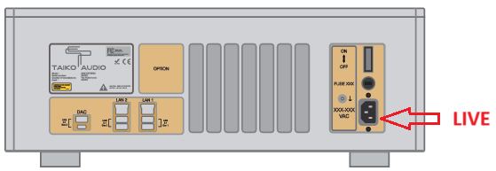

Hi Ulrich. Photo of the oyaide power inlet r which Taiko extreme uses below. In line with convention, the lower left pin is live and the lower right pin is neutral.
What Sablon Audio mentions is correct. Further, the connector is mounted in the Extreme Server, so the Live pin is at the bottom.
You can also refer to the table below, which indicates the standard phase position for female C13/C19 cable connectors.
Please keep in mind that these positions are mirrored/reversed in the chassis-mounted male parts!
