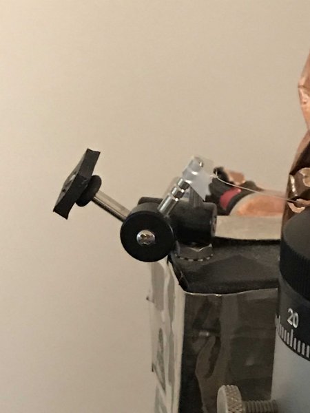

On this arm, there is 0 bias if you disengage the anti-skating device, and then there is everything else. So impossible to quantify any other setting; here's what it currently looks like:
The thread is attached to the top-most position of the right arm of this V structure which affects anti-skate in its own way; then, the weights and their position on the other arm of the V structure add anti-skate as well.
The only way to figure out what the anti-skate force is would be to somehow measure it, and I am trying to find a way to do it. But as Lederman/Schoeder say, the amount of this force needed would depend on VTF. Therefore, SME's approach of setting anti-skate as a percentage of VTF appears to be correct. Beautiful arms!
I see the thread is hooked to the first or top most 'groove' as there are 4 grooves to put the string on. Is the first groove the lightest, and the last groove at the lowest point the heaviest?
ack

So VPI's anti-skate mechanism is anything but scientific. The top-most groove offers the largest rotational angle from start to finish, and I chose it thinking that it would offer less of an anti-skating force. So nothing really scientific here.

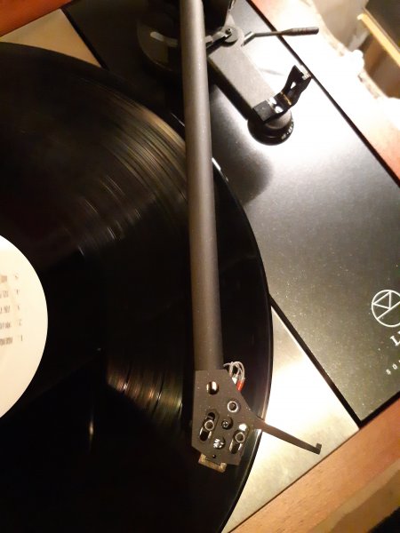

What it your arm's headshell offset angle? Can you post a picture looking from the ceiling?
Reactions: jadis

So I am wondering if the length of the arm plays a role here. Lederman/Schroeder say it's this headshell offset angle that creates this sliding force - not sure I agree entirely, because if the platter and LP are not entirely flat then they would also affect it - and under that assumption, would/could the arm's length make this force smaller or larger. Not sure, just throwing a question and idea out there.
Reactions: jadis

Ack, the longer the arm, the less the offset angle. The less the angle, the lower the skating force. Therefore, the longer the arm, the less anti skate one needs. At least that is how I understand it.
Imagine an infinitely long pivoting arm. The offset angle would approach zero degrees, or just like a linear tracking arm.
